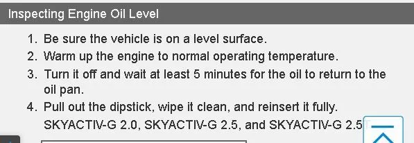

I don't know if I'd jump straight to oil consumption. Check the oil level again, according to the procedure outlined in your owner's manual.
attachment.php
Based on the process, the oil is meant to be checked while warm. Since engine oil expands when heated, it will read higher when the oil is warmed. I don't know how long the car was in operation while moving it to the show room, but either way, the very first oil reading you took was likely incorrect (you didn't wait 5 mins for the oil to drain into the sump). I would just check the oil level again following the procedure above. Top off if it reads lower than the full mark if you want to. Check the oil again after 3k using the same procedure, and if the oil level is significantly different, it's safe to assume oil consumption or oil dilution.

Ok checked it as indicated in the manual and the level is three or four millimeters under the full mark. I'm not going to top it off but just keep track of it until the first oil change in another 3000 kilometers. At least having checked it carefully today I will have something to compare with down the line.

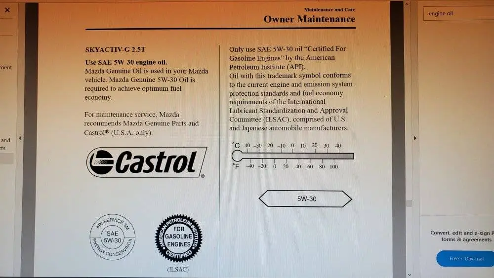

In my 2019 Owner's Manual shows "API Service SM" 5W-30 should be used for 2.5L Turbo. Anyone else noticed this? I hope it's a typo for API Serice SN which is mostly synthetic.

SM<SN<SN+<SP. In 2019 API SN + was still somewhat popular. API SP is the latest rating. They're all compatible. The below image was taken from Mobil 1 5w30 product data sheet. It meets all of them.
Car manufactures simply can’t catch the latest oil specifications most of time. Here’s the benefits of using different oils with different specs:
So SP / GF-6 oil offers the best protection to our engine, and most name-brand oils have met such certification.
2017 Mazda 6 Sport
SM is an obsolete spec from 2004-2011. SN/SN+/SP have all superseded it. All oils for gas engines made since May 1, 2021 have to meet the SP/GF6 spec
