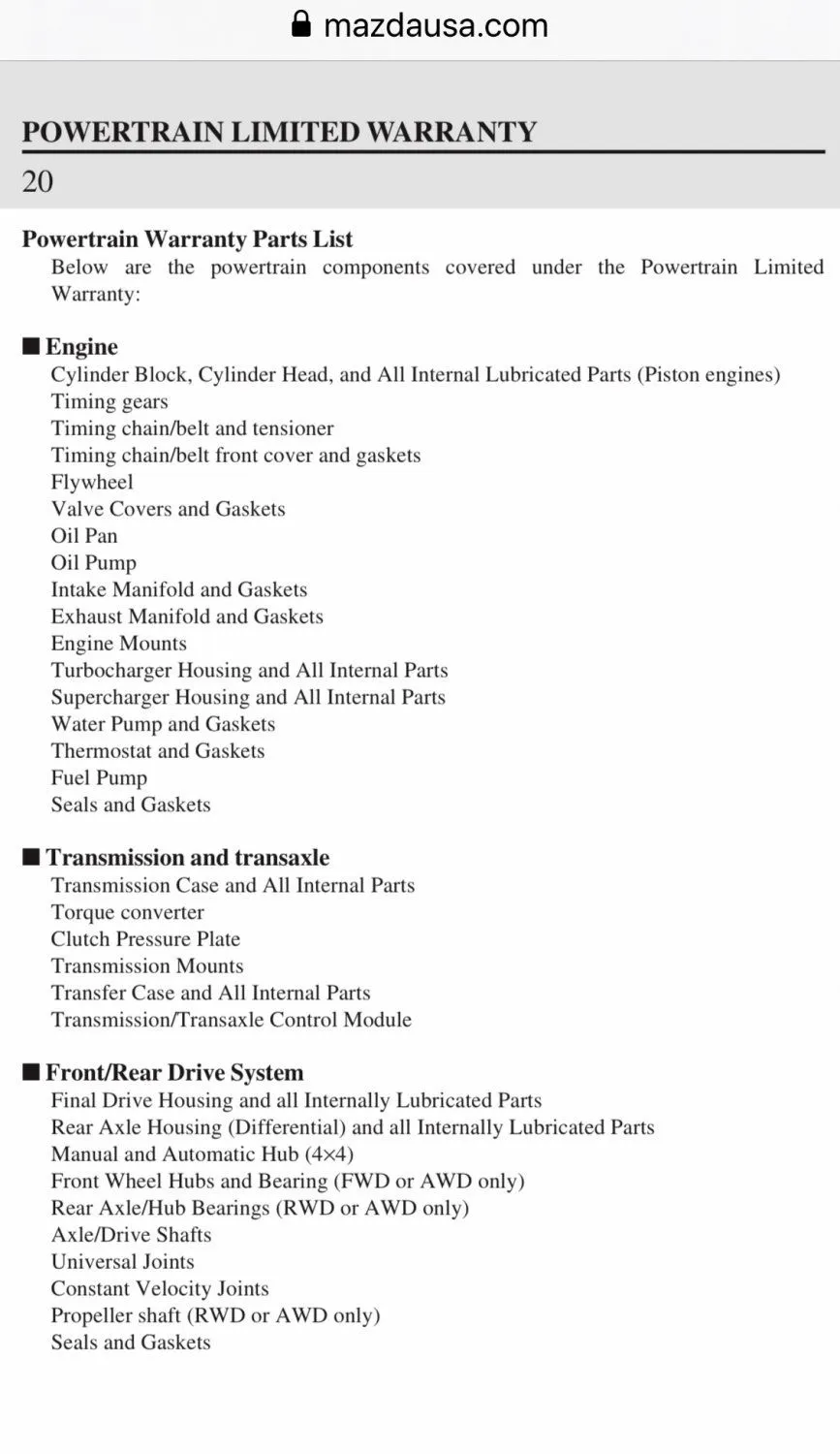

2017 Mazda 6 Sport
This is not the first time I heard of engine mount issue with Skyactiv engines. Hope OP can give us update later. On the side, I am wondering if engine mount issue is covered by powertrain warranty. Anyone knows?
they are covered
yrwei52
2016 Mazda CX-5 GT AWD w/Tech Pkg
Contributor
Plano, Texas, USA
they are covered
Yes, engine and transmission mounts are covered by Mazda’s 5-year / 60K-mile powertrain warranty, although OP’s 2015 CX-5 Sport with 53K miles shouldn’t have it (more than 5 years; 2016 CX-5 came out early in Feb. 2015 for US market) unless he has a CPO warranty.
https://www.mazdausa.com/siteassets...ed-warranty-booklet/2014-warranty-booklet.pdf
Engine mounts and the valve cover are absolutely covered under the powertrain warranty (page 20). The CPO warranty bumps the powertrain warranty to 7 years/100k miles. What was the first in-service date of the vehicle?
