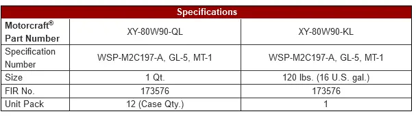

Motorcraft 80W-90 does meet GL-5 spec (MT-1 is for heavy duty non-syncro manual transmisisons):

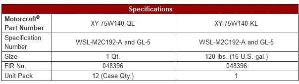

As does Motorcraft 75W-150:
