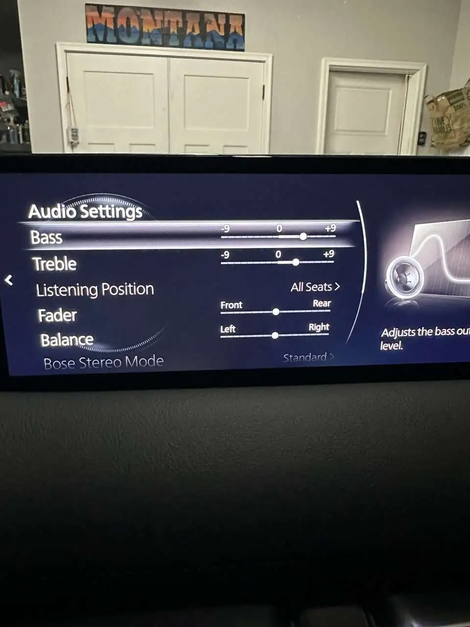

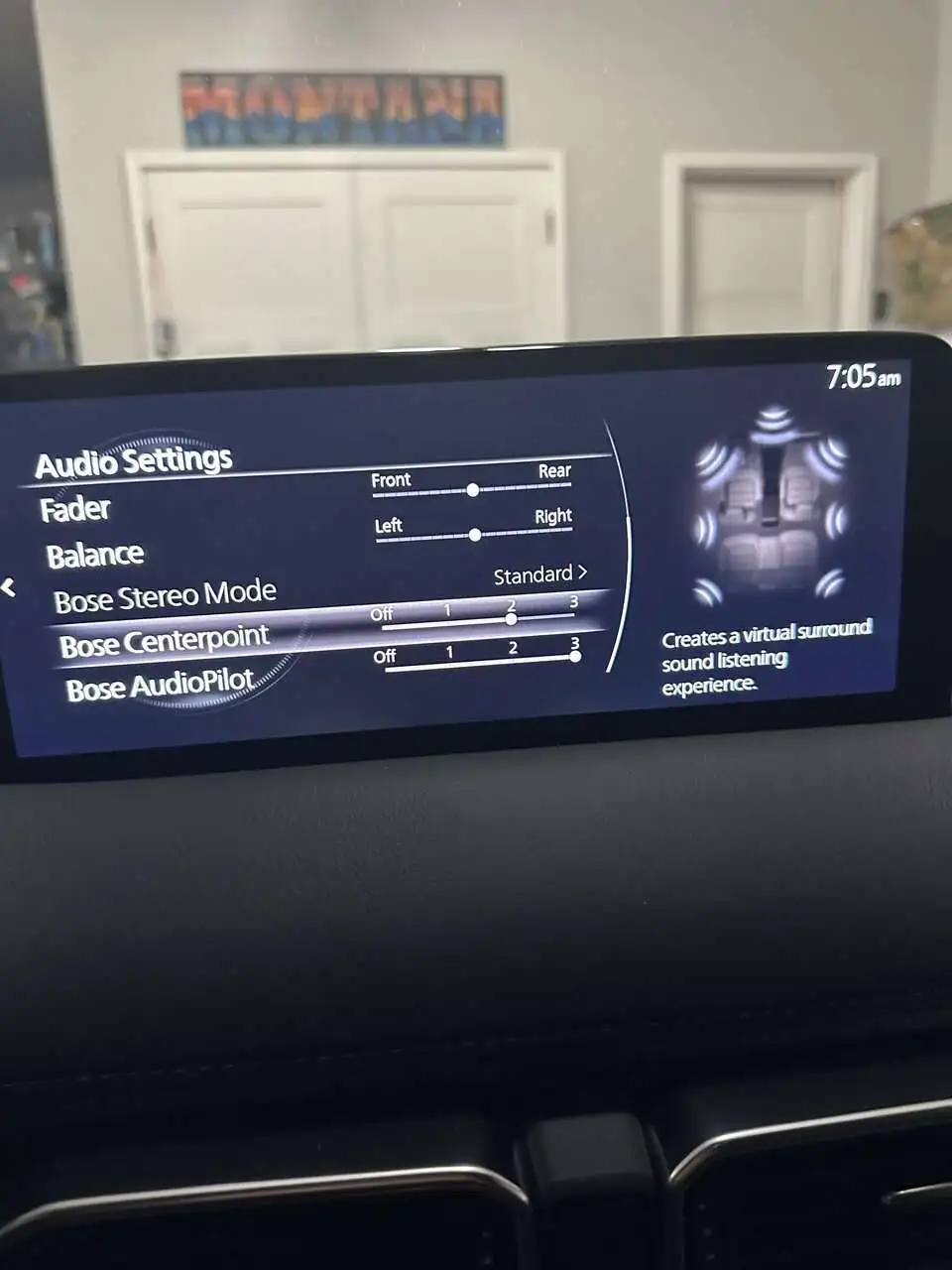

So be gentle and talk to me like I am a 6 year old as I am a bit tone deaf and an audio idiot. I always thought a center dash speaker in my 1978 f150 sounded fine listening to the am radio or 8 track lol...any way my new 2023 cx5 turbo is supposed to have the fancy 10 speaker Bose system. I have messed with the adjustments and really don't hear much of a difference but again I am tone deaf. How should I set it up so my passenger(s) have the best sound experience? mostly listen to 70''s and 80's soft rock and rock and roll with some old school country thrown in. FM radio, SirrusXM radio (usually the bridge, classic vinyl or outlaw country) Pandora etc. and some AM talk radio from time to time. Here is what it looks like on my infotainment screen. where should I adjust things to? thanks

I think many turn Centerpoint off completely, but I would experiment with all four settings to see what you like. Turn Audiopilot off completely.

I would set the Bass & Treble to center (0), faders to center, Centerpoint off, and Audiopilot to 1 or 2. (Note: AudioPilot does not alter tone, but just automatically raises/lowers the volume based on car speed & ambient noise.)
View attachment 317389View attachment 317390
The Mazda's 10 speaker Bose sound system is specifically tuned for the front passengers only. The placement of the speakers is good, but the power is fed by a terribly low power amplifier. In order to mitigate this, Bose uses softwares like Centerpoint and AudioPilot, which have their own pros and cons. This is my suggestion.
Bass = +3
Treble = 0
Stereo Mode = Standard
Turn off Center point and Audio Pilot
This combination ensures the best clarity of the sound spectrum.
Now, adjust the "Fader" all the way to the rear, and keep on bringing it to the front. The best point I observed is 1/4th right from the "0", so it might work for your passengers as well.

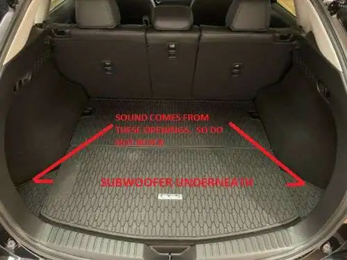

Also, do not cover/block the openings in the cargo area as shown in the below picture. That's where the sound from the subwoofer travels to the cabin. This is also the reason why Mazda offers a split design cargo mat (one main and two separate side covers). If you are looking to buy a cargo mat, do not buy a single unit which blocks the two openings.
