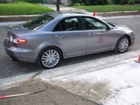

Hello all, my first post here. I bought my own Titanium Grey Mazdaspeed6 yesterday and was hoping to join you club. I got the GT, with sunroof and sirrius. I bought an extended bumper to bumper warranty 5year/100K miles.
Just curious if you guys could help me out with some issues such as, can I put tires on it that are not low profile, as in all season or snow tires for the winter. I have heard that the wheel arches cannot handle larger diameter tires. Also, dealership told me to go ahead and use conventional motor oil. Should I be using synthetic? Any other maintenance tips would be appreciated. Also, this is my first turbo, any tips to maximize my fuel economy when I want to. Thanks guys

Congrats and welcome!
Tires - you can change to all season or winter if you'd like. You can't really get away from low profile, but you can get a little larger without any problems with a 225/45/18. That is the size I got for my Blizzaks. You can also go with 225/40/18 or the stock 215/45/18.
Oil - Most people switch to synthetic, but you don't have to. I did because it is better for the car in my opinion.
Turbo - If you want to maximize fuel economy, get a boost gauge and try to stay out of the boost when you want to save gas :).
