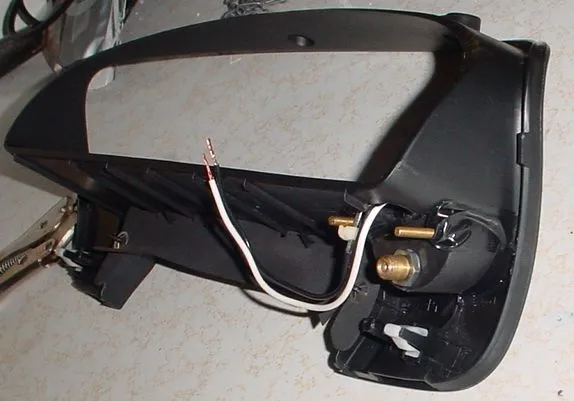

Getting the LED out is easy. First unplug the LED from underneath the dash. Then get ahold of the LED from above and gently wiggle it out - it's only set in there by friction. Make sure the wires are straight and the wiring should come up through the hole where the LED was. That's it.
If you want to remove the instrument surround as well, there are 2 philips head screws at the top of the instrument cluster surround, remove them. Pull down slightly on the top of the instrument surround and it'll come forward. At the bottom of the surround there are 2 pop fasteners, pull straight toward you and they'll pop (picture below should help). You don't have to remove the surround to get the LED out tho.
