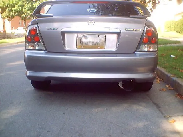

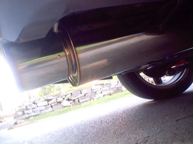

After procrastinating and putzing around for roughly four months, I finally got my exhaust hooked up!
Considering the psychotic requirements for emissions/inspection in PA, I couldn't do anything too dramatic. PA says that you HAVE to have at least two cats somewhere in your exhaust system, unfortunately .. so here's what I wound up making for myself.
I kept the silly little stock 'downpipe' into the first stock cat. Cut out the second stock cat, and replaced that with a 2.5" Magnaflow hi-flow cat. There's about four inches of expanded piping between the first and second cat, obviously. I ditched the resonator -- there's nothing but SS piping from the hi-flow cat back to my muffler. For a muffler, I went with the HKS Hiper style, with the 3" piping and 5.5" titanium tip.
It sounds GORGEOUS. I was a bit worried that without the resonator, the exhaust would be a little too loud. But it's perfect. The system has a relatively quiet, though somewhat growling, idle. A deep, smooth tone through the RPMs up till 4500 or so -- and then it snarls through the high RPMs. It's great. And I can feel a difference with how the MSP pulls, as well. Not as much stuttering through the gears, and more even acceleration.
All told, with parts and labor, the system cost me just short of $700. And it's money I'm happy I spent! I'll see what I can do about getting up some sound clips and pictures soon. :D

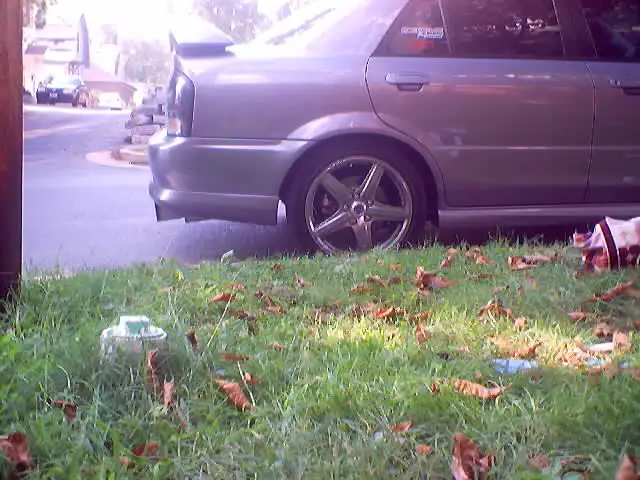

Okay. I only have three pics .. and, in all honesty, the quality is pretty bad. I need a new digital camera desperately. But these at least give you an idea. And just as a note .. the one picture, from the side, makes it look like the muffler is sitting at a downslanting angle .. but it's actually not. My camera just sucks that bad.
I'm gonna see if I can borrow a friend's camera to get some better shots, as well as some sound clips. :D

looks good...though that really doesn't look like a 5.5" tip. u sure it's that big? hks's website only lists their Ti muffler tip at 120mm (4.72 in.). either way, it looks good. and if you can get me soundclips, i believe you will be the first msp to provide a soundclip with an HKS Hi-Power muffler :) and i'd finally be able to update the exhaust thread!!!

Striker -- Y'know, you could be right about the size. In all honesty, I did a quick conversion using some weird online calculator to go from mm to inches. Wouldn't surprise me if I hit a wrong button, heh. But I'll talk to one of my housemates tomorrow about using some of his tech equipment to get sound clips, as I currently have nothing .. and I want people to hear it, cause it sounds GOOD.
