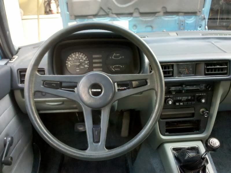

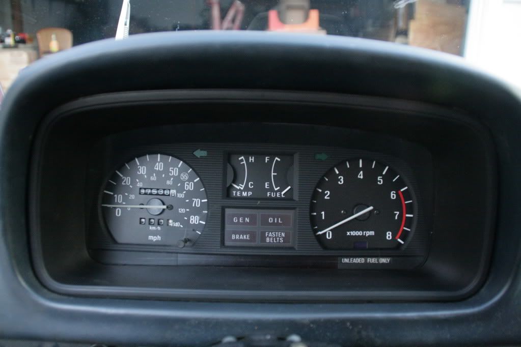

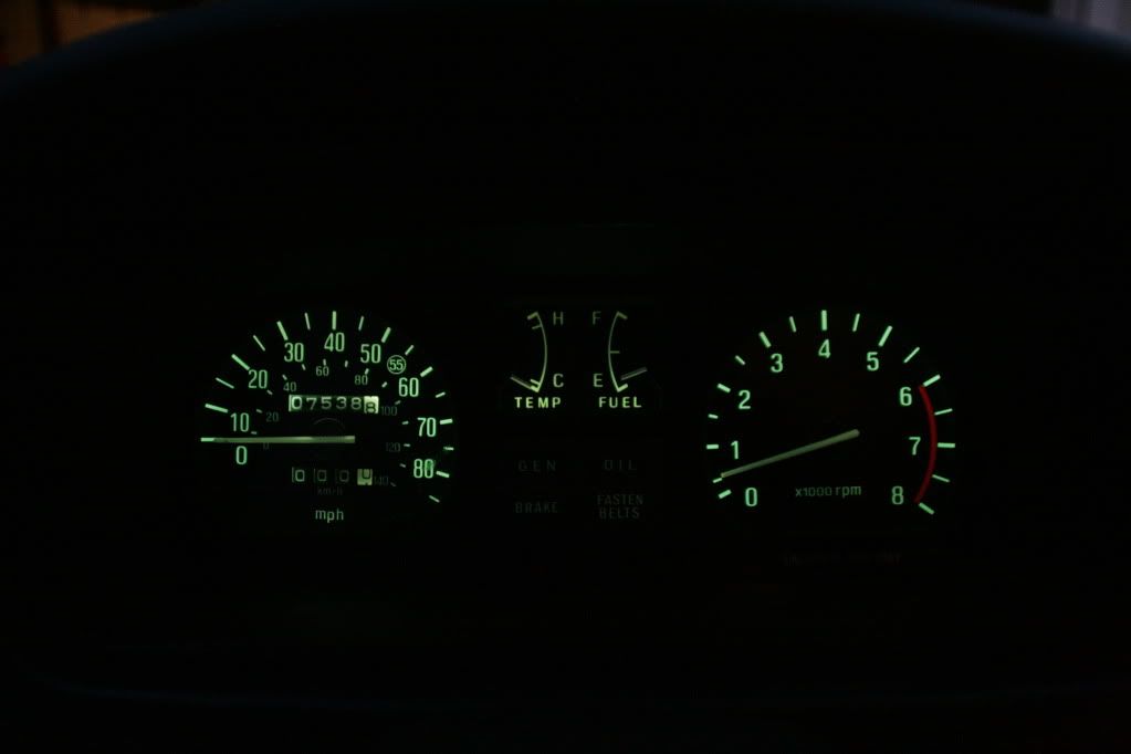

and got some goodies in the mail last week, and installed my gauge cluster.

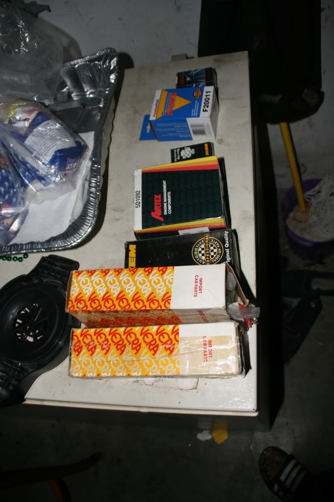

Spent a total of 70$ on all these new items! I love old cars...lol
coil
disty cap
rotor button
spark plugs
inner tie rod ends
oil pressure sender
temp sensor
new plugs
old plugs...:(

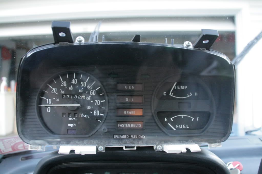

Old cluster out
New cluster in, pulled from a 82 coupe, has tachometer,gas light,taillight warning,coolant light

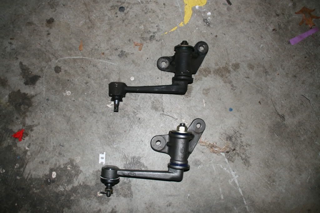

idler Arm

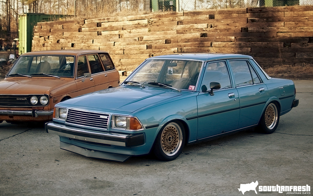

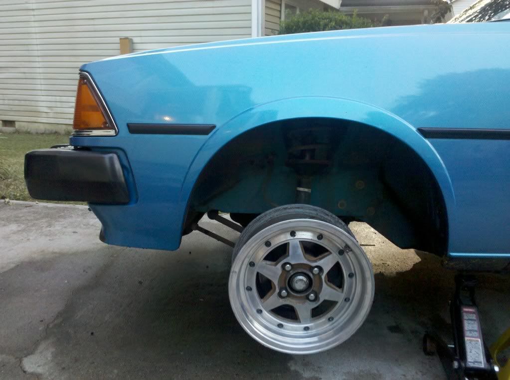

Finally got low!
Changed the suspension over to 1st gen Rx7 suspension, and brakes.. and it got me mylow!
