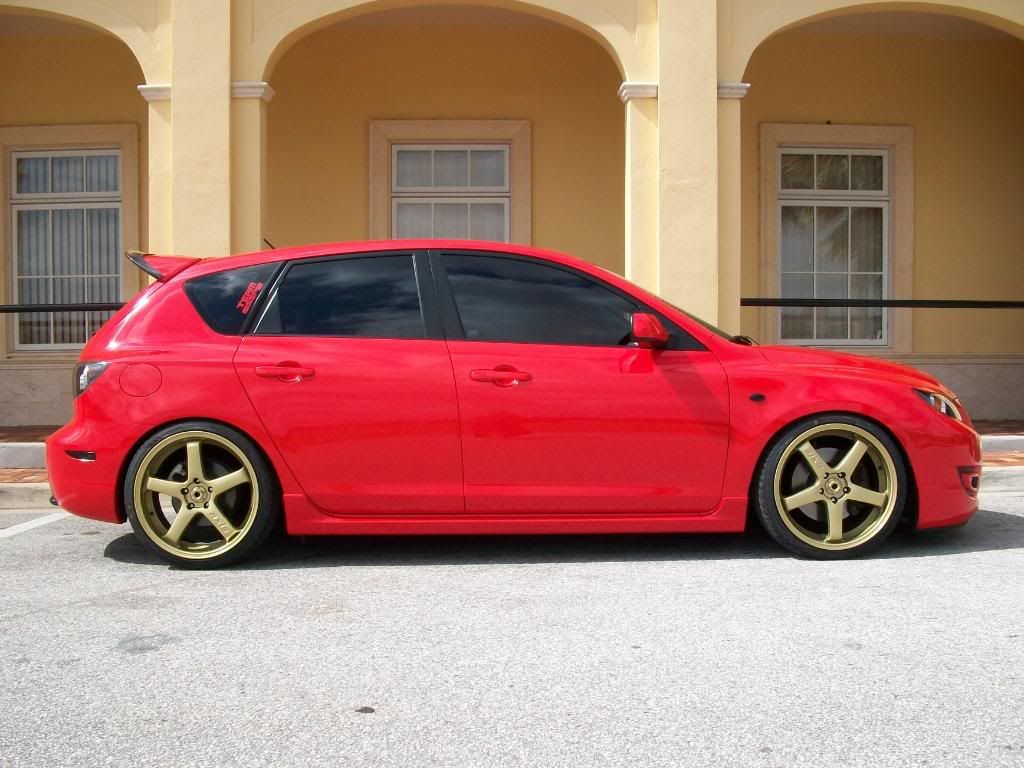

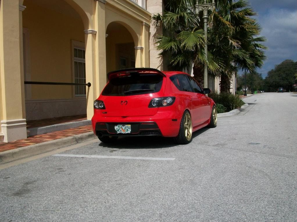

2.Wheels: Rota Torques(gold)
3.Wheel size:18 x 8" +35
4.Tires:Nitto INVO
5.Tire size:225/40-18
6.Suspension: BC coilovers
7.Im unsure at the moment...lol
8. Rear qtrs. hammered flat and pulled, then repainted
9.Rears rubbed when I went over big bumps and steep driveways
10.The wheels clear nicely now, i am going to lower it down some more
11.It sits nice and flush, the wheel edge is exactly in line with the fender
