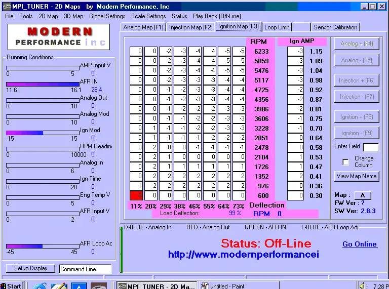

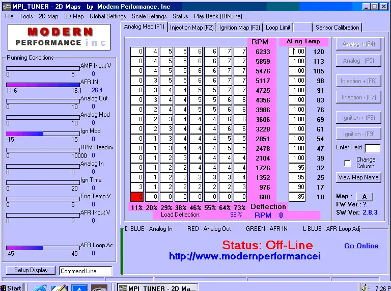

yea get that workin and post those maps..I'm going up to Long branch in a bout a week for some major tuning, since I'll have my MP3 ecu. My bad P5 ECU idle will now be gone, so I want to get it perfect again with the stock ecu
Here are the new maps i have created. My idle feels much better..Even though sometimes my idle still runs lean..I haven't tried putting 0's yet..b/c i had it stall couple of times..
Chas
