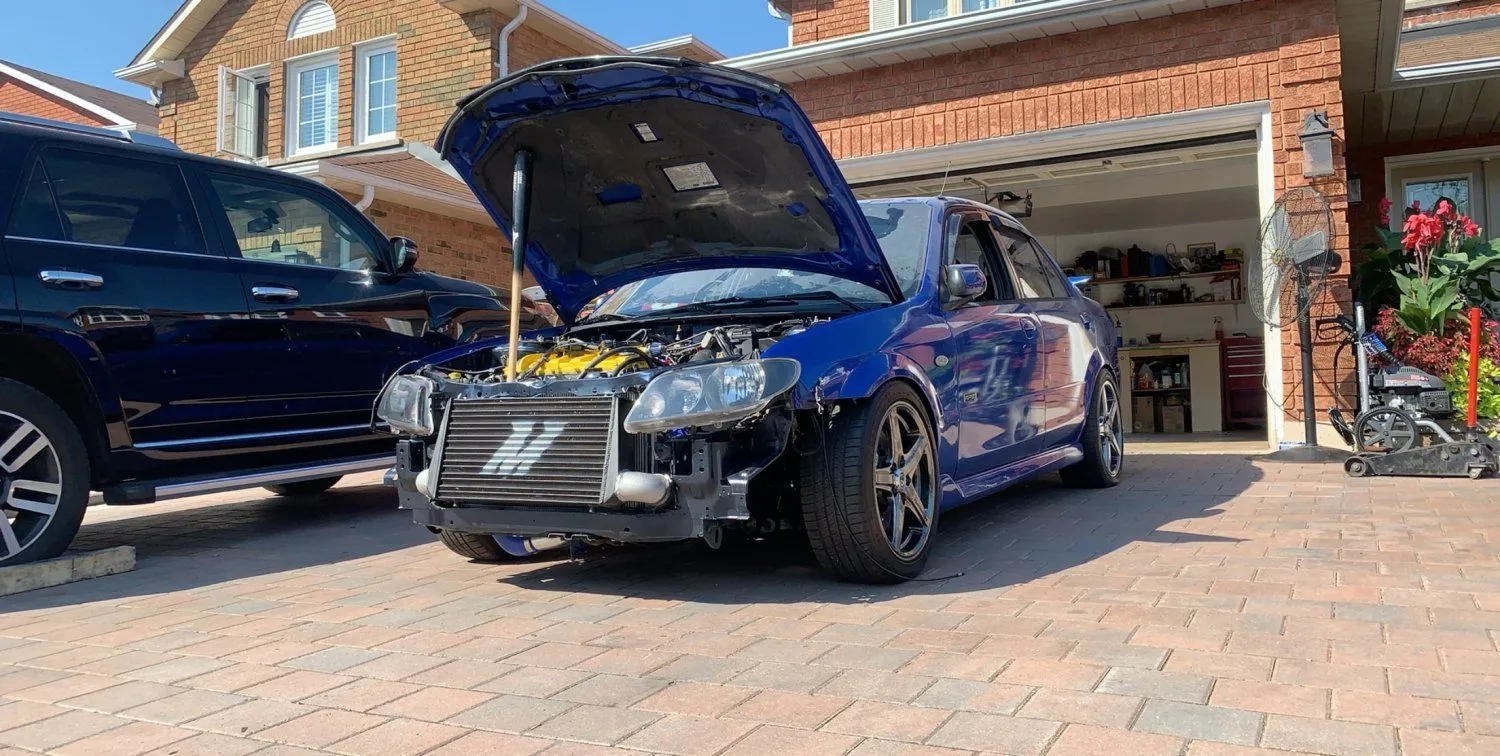

MP3 GTX3076r Gen2 Built Top Bottom and Trans
2001 MP3 Protege
Mod List
Suspension & Appearance
BC Racing Coilovers
Racingbeat Front & Rear Swaybars
03.5 17x7 Gun Metal Racinghart wrapped on Michelin Pilot Sport 225/45/17
Stoptech Front BBK
Drilled Mazdaspeed Rear rotors and Calipers
Mazdaspeed Engine Strut Brace
Stoptech SS Brake lines
AutoEXE Front Lip
MP3 Rear Wing
Mazdaspeed Rear Valance
Engine
Supertech +1mm Oversized Intake & Exhaust Valves
Supertech Titanium Retainers
Supertech Dual Valve Springs
Supertech Valve Seals
Corksport FSZE Exhaust Cam
Cometic Headgasket
Wiseco 83.5mm 9.0:1 Pistons
Pauter Rods
ARP studs
Mazdaspeed Forged Crankshaft
OEM Bearings
Hydra adjustable Cam Gears
Hydra fuel rail + 6an lines from firewall
Aeromotive Fuel Pressure Regulator
Walbro 255
440cc
626 VC
Stock intake manifold w/ VTSC/VISC & EGR Delete
Custom Pope Manifold w/ EGR Delete & 44mm Tial External Wastegate
MAF relocation
Greddy BOV
Turbosmart Manual Adjustable Boost Controller
Mishimoto M-Line Intercooler
Mishimoto Radiator & Fanshroud
Pope 3” DP
Cat delete
Custom 2.5” Magnaflow Catback
XClutch Flywheel & Twin Disc Clutch
Hyrda Lightweight Crank Pulley
A/C Delete
Haltech Elite 550 parallel w/ MP3 ECU
AWR Engine Mount Kit
Transmission
Mfactory 500whp+ Forged Gear Set
Mfactory LSD
Mazdaspeed Axles
Exileautoworx Reinforcement plate, trans saver & shifter bushing
Corksport 3rd link shifter busing
TWM short shifter
sm1ke
Work In Progress..
Moderator
Contributor
Canada
'18 CX-9 Signature
Custom hood prop is a nice touch, lol. What a beast. Looking forward to seeing and reading more about your car!
