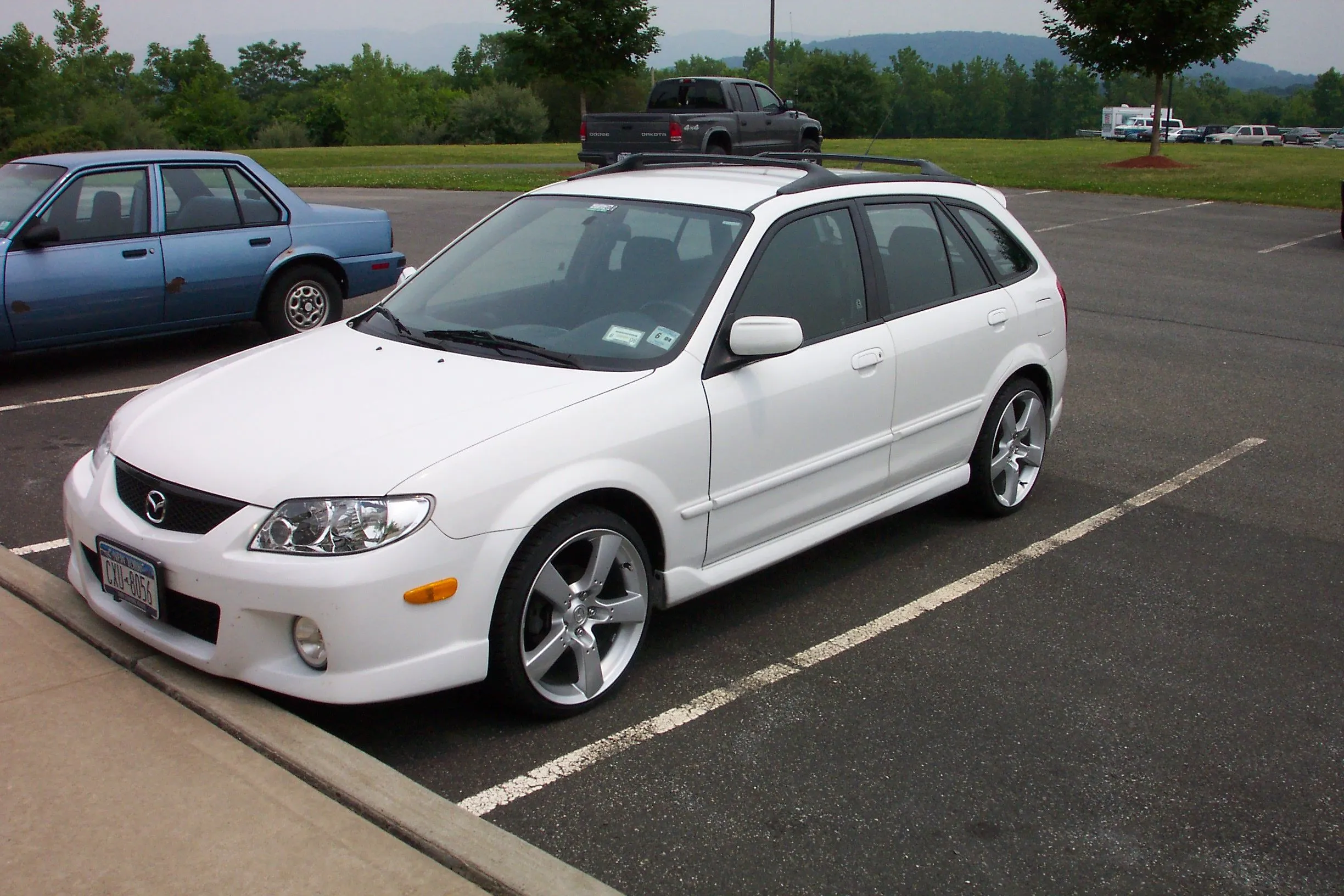

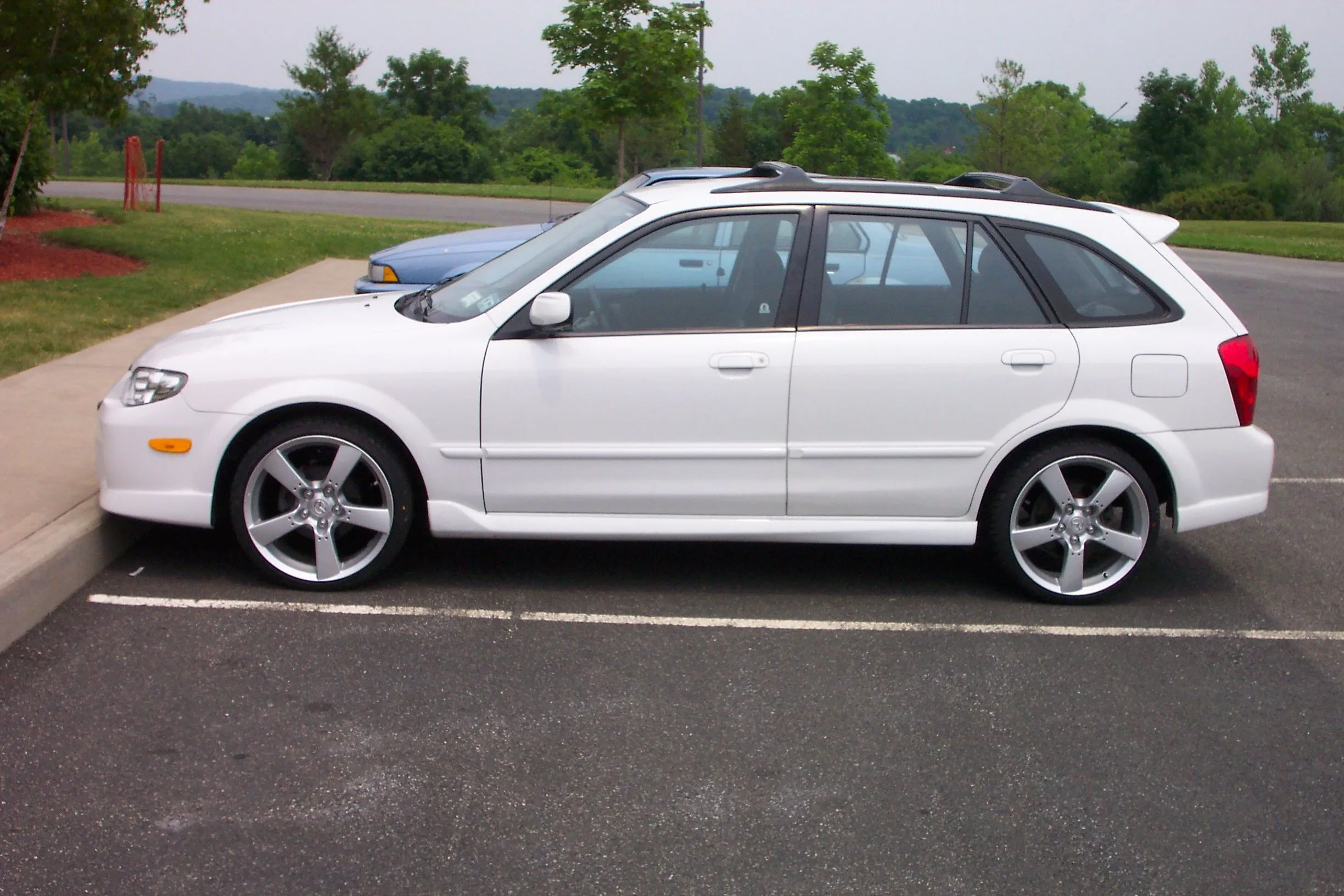

Just mounted some RX-8 wheels on the car today. Check pics out there is no rubbing at all. Had to go to 215/35-18 to get them to fit. Anyway check out the pics.

... are those rx-8 rims? looks smaller than the other p-5 with rx-8 rims...
is your car lowered at all?

Yeah they are the RX-8 wheels. No the car is not lowered yet!!!

How wide are they, are they just 18 X 7, or 8...I think the RX-8 wears 225's in back, which seems a little wide for a 7" wheel...
but anyway...he didn't appear to have any rubbing problems at all, and the MSP is lower than the P5...I am not sure of the offset of the RX-8 wheels...but it appeared that the tire sidewall tucked perfectly under the the fender....Looked like they should have been stock wheels...

Looks nice man, however i dont know how u run a 35series tire in NY...I have a hard time just with my 215/45/17 set up,...
NYC king of potholes
The RX8 wheels are 18X8 +50 offset.....awesome stock wheels. I love them. I was waiting to see what other cars people would put them on....the P5 looks crazy with them on....I love it.
