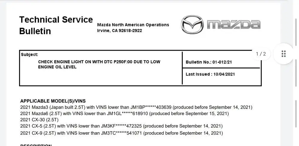

The cut-off date could be just the change date on revised valve stem seal. Mazda admitted that the root cause of this oil consumption issue hasn’t been identified yet, hence a repair procedure isn’t available for the 2.5T.
From the TSB # 01-012/21:
DESCRIPTION
Some vehicles may have a “LOW ENGINE OIL LEVEL” warning message and a CHECK ENGINE light illuminated in the instrument cluster, along with DTC P250F:00 stored in memory.
• DTC P250F:00 - Engine oil level signal: engine oil level low
Upon inspecting the engine oil level, the level is found to be low and there doesn’t appear to be any trace of oil leakage in the engine compartment. This concern usually occurs when the mileage reaches approximately 3,100 – 4,700 miles (5,000 - 7,500km) and may also occur again after replacing or topping off the engine oil. The root cause of this concern has not been identified yet, therefore a repair procedure will be announced at a later date. Since this issue has been reported after a valve stem seal modification, it is very likely that valve stem seal damage is causing oil to leak into the combustion chamber.
DESCRIPTION
How can Mazda say "we do not know the cause" and also say "we know the exact production day that we solved the issue", in the same tsb?
Sounds like a question for Mazda. I personally am not familiar with their internal processes and how they make decisions on what info is included in the TSBs and why. You may be interpreting the VIN range as an indication of when the issue stops being an issue, but like yrwei said, it could just be an estimation based on the change date of the revised part.
Whenever I write the equivalent of a TSB in my line of work, it includes a range of affected units, the issue(s) to be aware of, a resolution (if available), and the cause of the issue (if available). Sometimes if the cause hasn't been determined yet, the bulletin is released to the dealers anyway, to inform them that we are aware of the issue and offer any potential workarounds, temporary resolutions, or general support until a more permanent resolution becomes available. At that point, the TSB is revised.
As far as the range of affected units in my industry, there are a few different ways to identify the potential range, depending on what the issue is. For example, for a transmission related software issue, we would keep track of the TCM software version in the affected units. With that information, the TSB would include the serial numbers of all applicable units that came off the production line with that software version. Each software version release includes a serial "cut-in", which indicates the serial number of the first unit that the new software version is installed on.
Again, this is how it works in my industry (more or less). Mazda's processes are likely similar, but I don't know for sure.
