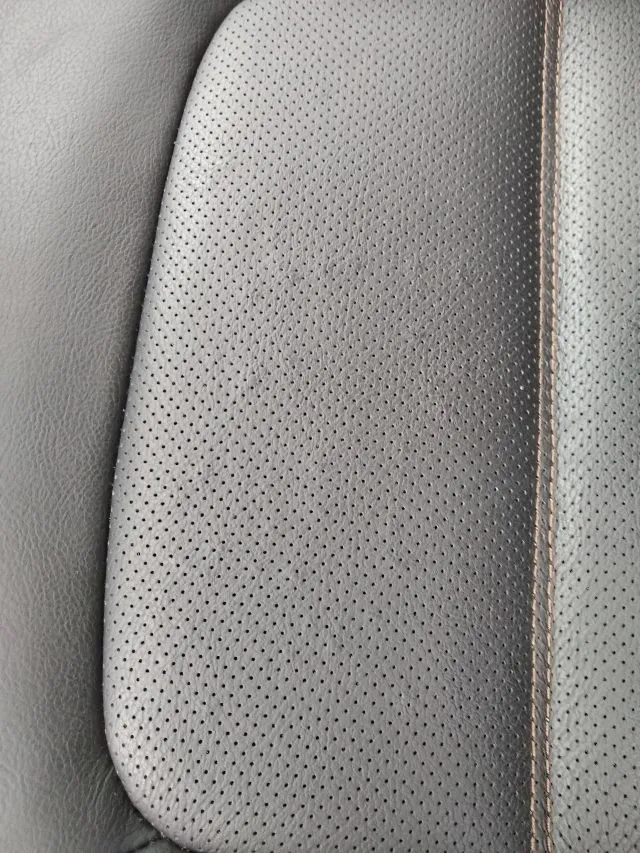

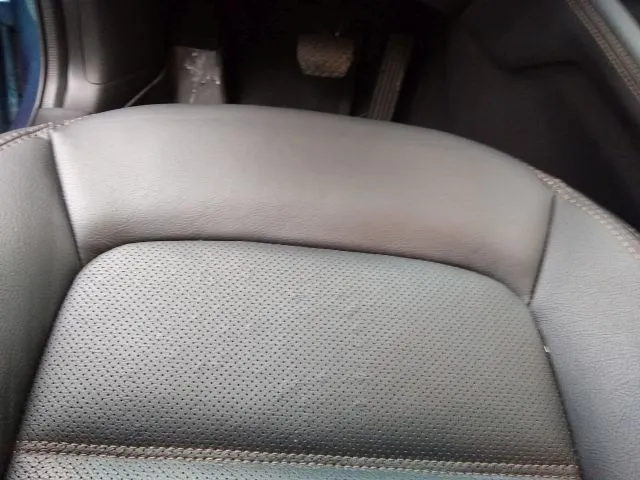

Here's a pic of my driver's seat. I'm taking it to the dealer next week. I hope they don't give me a hard time.
My passenger seat is fine, but it only gets occasional use.

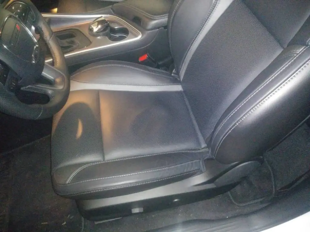

Oof. I don't know what all those little points are from. Mine was more of a big bump where your butt goes. More like this (just an example, not my photo):
The service tech said he never had anyone bring it in for that so he had no point of reference for what was normal wear but he agreed it seemed too soon for it to occur and offered to order new parts. It's been a week and I haven't heard back but he seemed like an honest guy so he probably just shipped it slow since it's non-urgent.
May be you can show the leather seat TSB to your Mazda dealer along with reporting moisture problem.
CX-5 leather seats have the same issue. Here's a long thread discussing this problem:
2018 CX-5 Grand Touring Leather Seat Issue
And here's the TSB for your problem:
Ref. No. R054/18 - Warping Surface of Drivers Seat
There're revised parts listed in the TSB to fix this problem.
Ref. No. R054/18 said:
CAUSE
Gap occurs between the leather surface and the cushion pad due to insufficient surface tension of the seat trim.
MASS PRODUCTION CHANGE
A non-woven fabric is attached to the backside of the front seat cushion trim to enhance the surface tension.
REPAIR PROCEDURE
When you receive the customer complain on this concern, replace the front seat cushion trim(1) and the front seat cushion pad with a modified one according to the workshop manual FRONT SEAT CUSHION TRIM REMOVAL/INSTALLATION.
