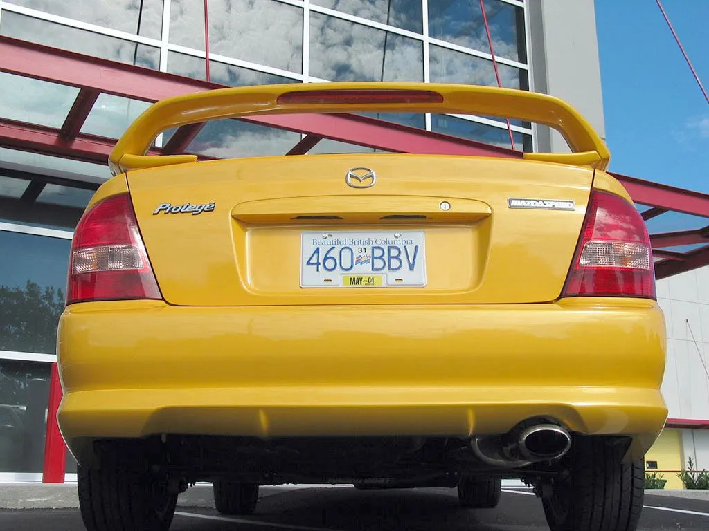

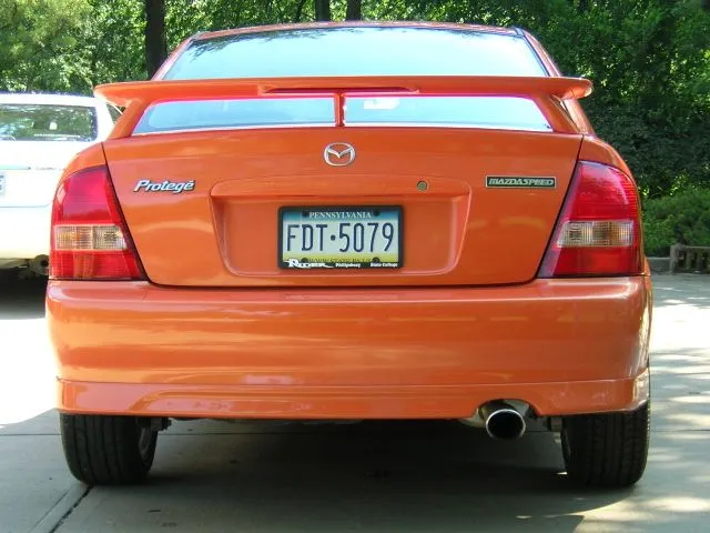

I got two pictures here. Since i know that the 2003 tip will fit under the notch on the protege 5 bumper anyone care to compare the diameter on the 2003 and 2003.5 tip. side to side i mean not from top to bottom.

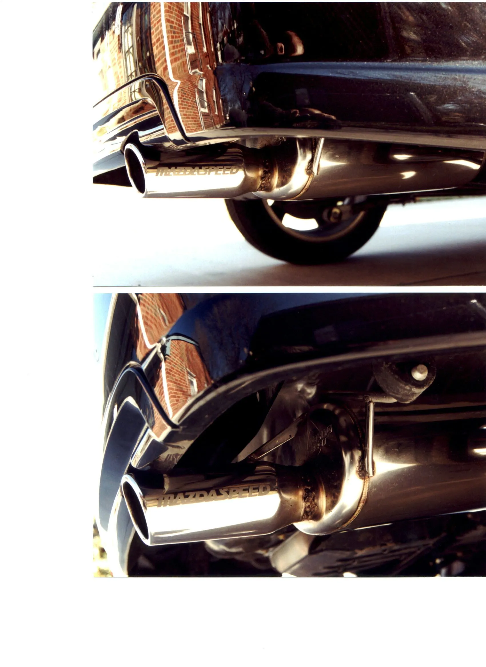

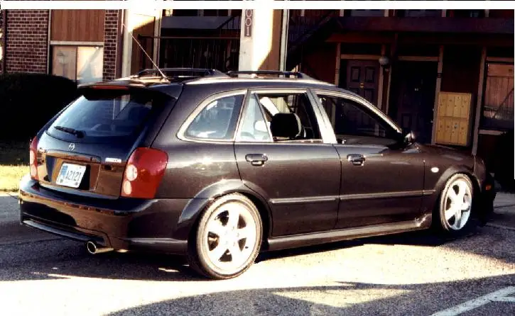

MSP exhaust on my P5, you have to cut and reweld the tip, as the p5 is some 5" shorter in the rear.. use a stainless weld so the you dont get rust on the exhaust, always looks good.. all fits good, no problems

Hehe i understand that you have to cut and weld it plus the tip on the MSP 2003 exhaust will fill into the notch. But i was wondering if the tip from the MSP 2003.5 exhaust will fit under the notch =)
Just had the tip shortened on the 03.5 MSP exhaust I purchased. Hoping to install it in my P5 this weekend. I'll let you know how it fits.
Ya know, while it really does look good in general, there still is a part of me that wants to grab a sabre saw and trim the rear skirt to follow the tip, LOL. But you had me going for a while Ken, where I really had my doubts if it would fit.
