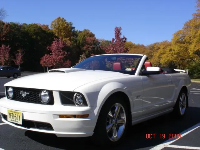

I attached a Pic of the Mustang, just because I like the photo. I have used Turtle Wax Ice on it since that Photo was taken and the paint and trim look new. The Mustang does live in my garage though.
