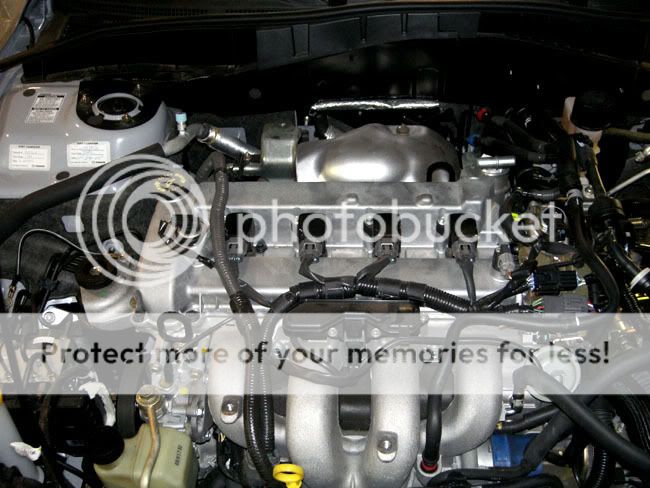

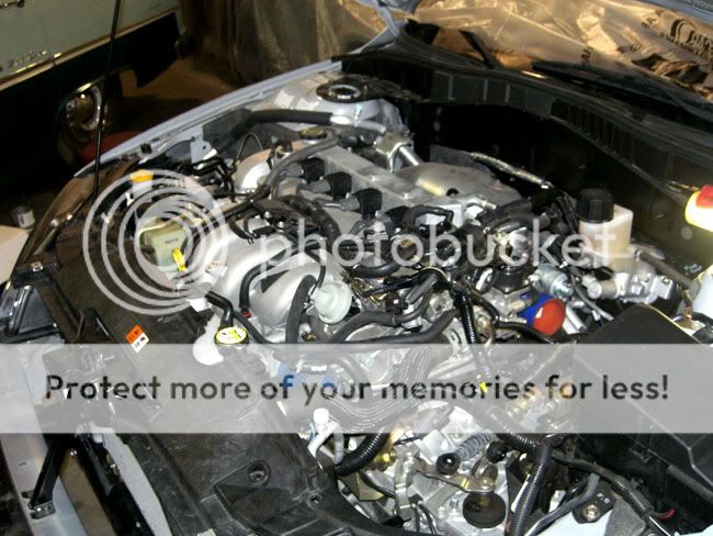

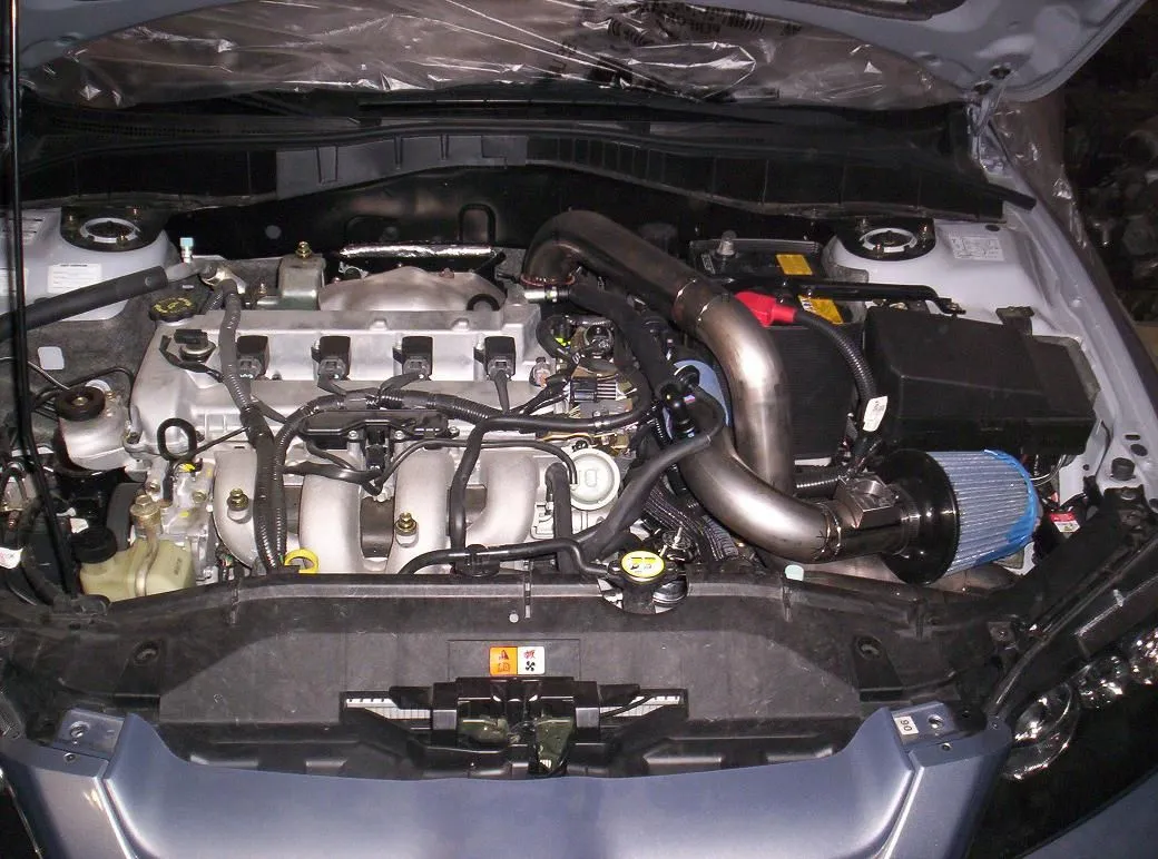

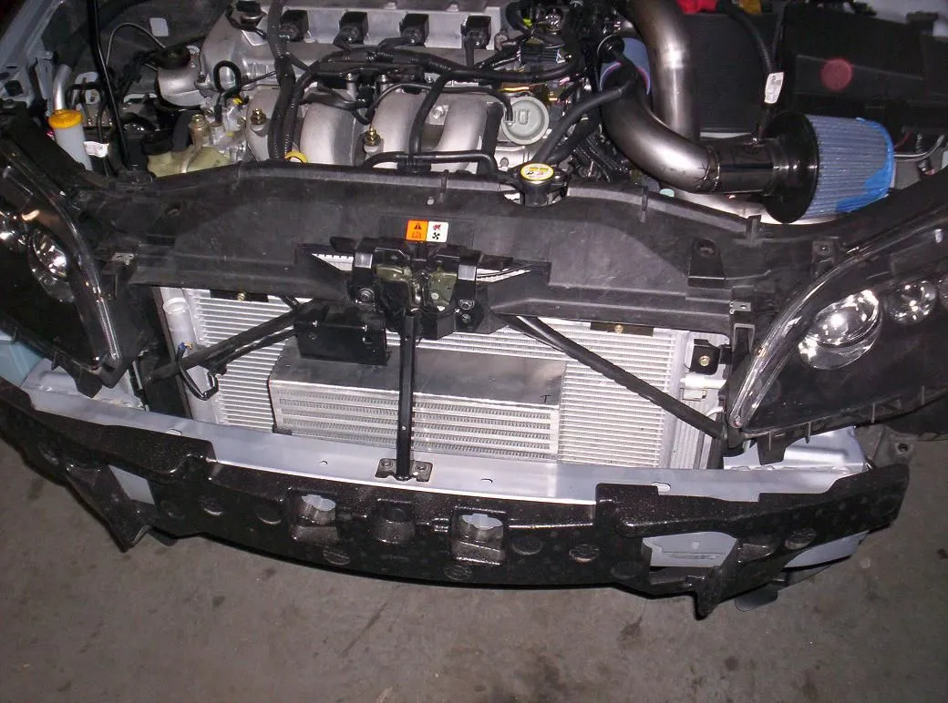

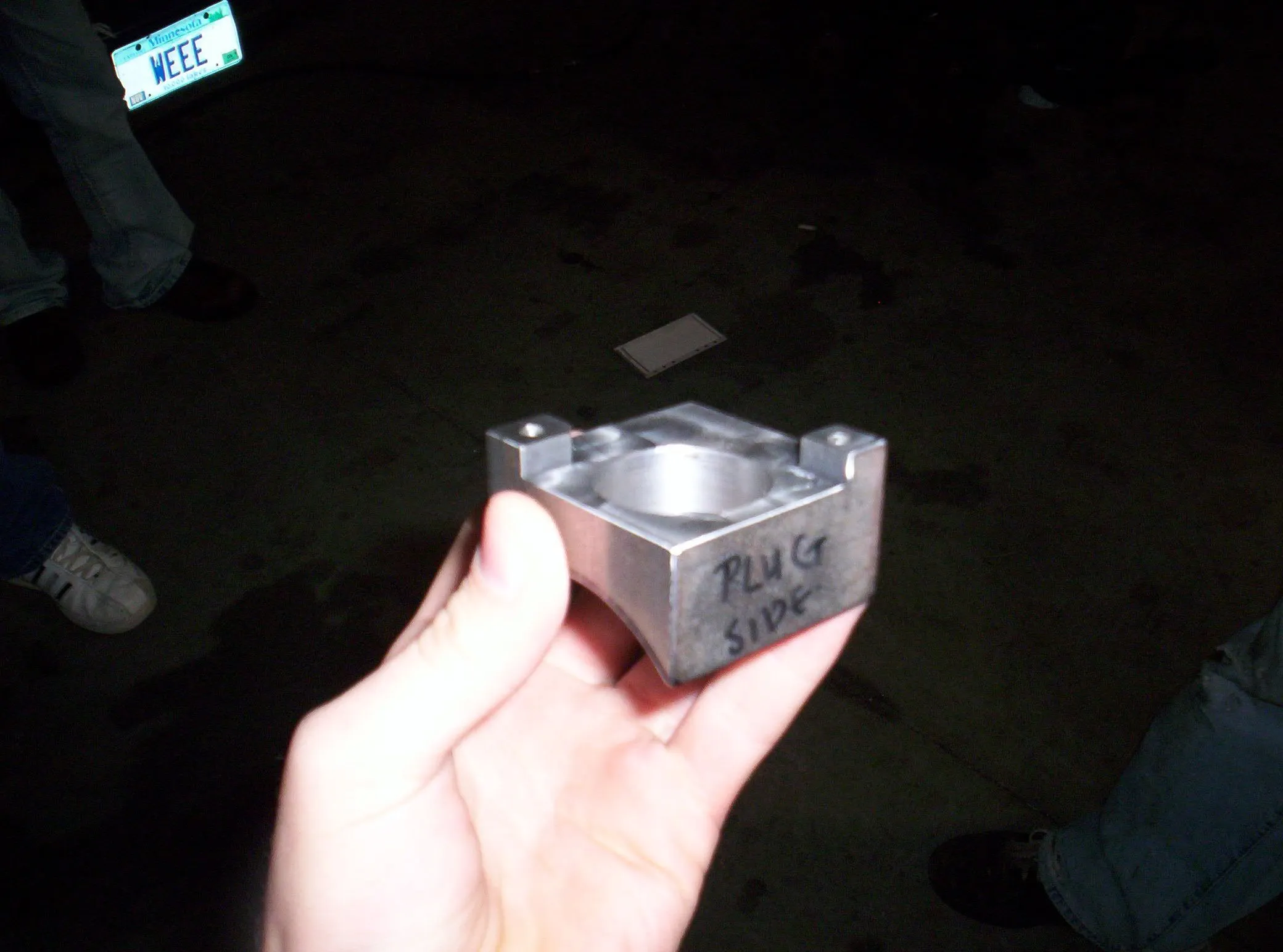

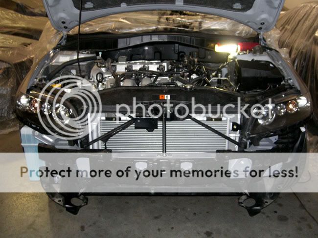

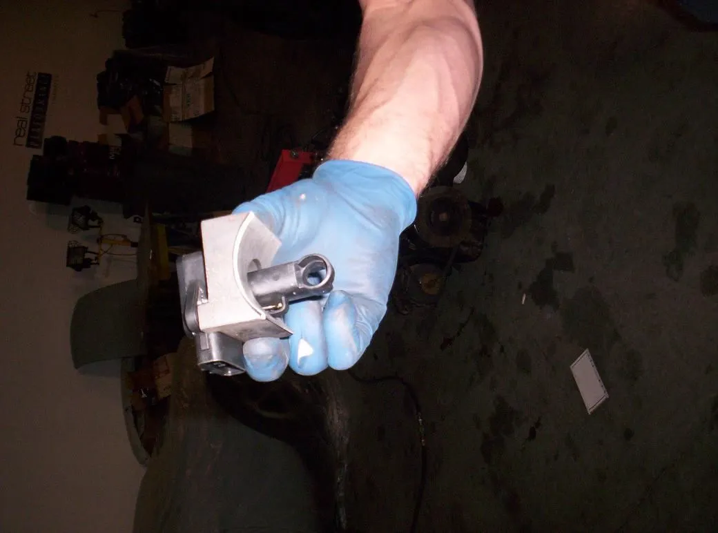

Here we are ladies and gents; ProtegeGarage's FMIC kit for the MS6 is getting the final details tidied up and is ready for full production. This is a high quality kit that cuts no corners and is a complete solution needing no modification, no cutting and no addition purchase by the end user. Simply install and drive. The components included are;

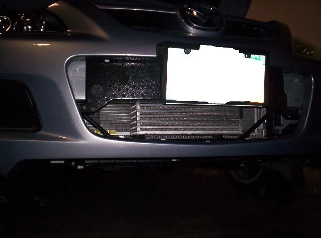

- Bar and Plate Intercooler Core from Bell Intercoolers (www.bellintercoolers.com, www.bellengineering.net) Size: 3" thick, 14" long, 11" tall. Anyone who knows anything about turbocharging and forced induction knows nothing will outperform a BEGi core.

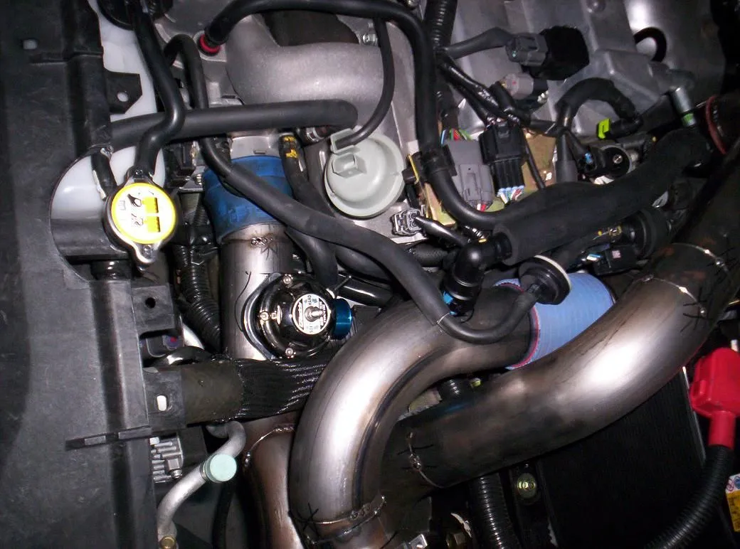

- GReddy RS Blow Off Valve with machined recirculation fittings

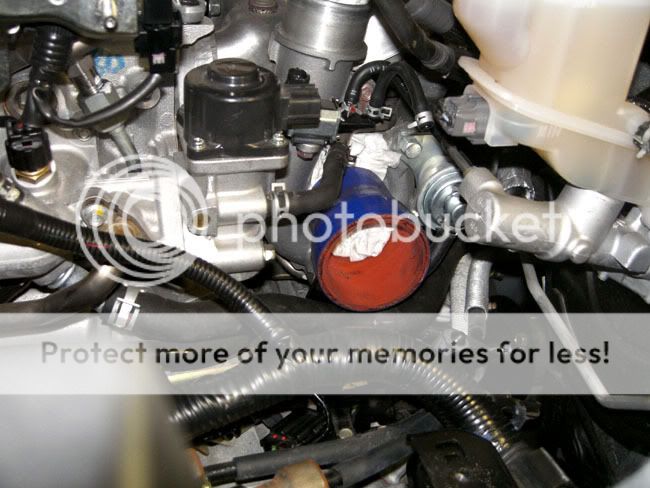

- Precision machined MAF sensor mounting point
- Polished stainless steel pipes
- Vibrant Hardened Heat Resistant Couplers
- Constant Torque Stainless Clamps
- Custom Air Intake setup complete with K&N Air Filter
We'll announce final pricing next week as well as dyno results from the installed kit. There will be introductory discount pricing for forum members, so PM me if interested.

Damn...what do the end tanks look like? It is good that the kit requires no cutting. I can imagine that it will cost a pretty penny though.

endtanks will be on the car this weekend and i will get some pictures of them then for you all. we're trying to bring the kit in at a good price point, but keep in mind that you are getting a complete kit with an intake, quality parts from companies like BEGi and Greddy as well as precision fabricated components for things like PCV and MAF. the first ten kits will be sold at a discounted rate.

Relocating that AF sensor is probably going to cause CEL's. Has the car been driven with the kit, it does not look done in the pictures?
correction - kit will have not welded joint, but fully MANDREL BENT mirror finish stainless piping
moving the mafs will not cause a cel its just like a cai it dont move 12" lower than what it did before it will measure the air the same way even if it was located at the tb it will still read just fine as long as theres no leaks and the bov return is behind it.

This kit will not work with any existing CAI setups... Which is a problem for a lot of us. So, if you want a front-mount... you're probably gonna have to try and sell your CAI to other members who aren't planning on that mod...
As for the BOV.... I would really like to know if we can use our own... or if the bracket is welded onto the system already.... I think its a great idea doing a FULL custom kit like this.. intake (not cold air which is kinda sad)... BOV.. everything included with no cutting ... Is awsome....

Thanks, I can deal with that reply. As many different companies have made intake kits for cars and given them a CEL, especially turbos. I am still a little concerned.
In theory I believe you to be correct. In practice, and I do't know why, the placement of the meter seems to be very dependant on where it is in the system as you said. Changes in bends, straights etc effect velocity and flow. While the changes would seem negligable it seems to matter significantly to the ECU/sensor, it is just something I have observed.

i think the trade off will be worth it honestly. we expect good numbers from this kit and quality of parts and work included will be well worth it. the GReddy bracket is welded into place but I can have it setup to accept the stock valve and perhaps discount the price down. i'll look into doing that
