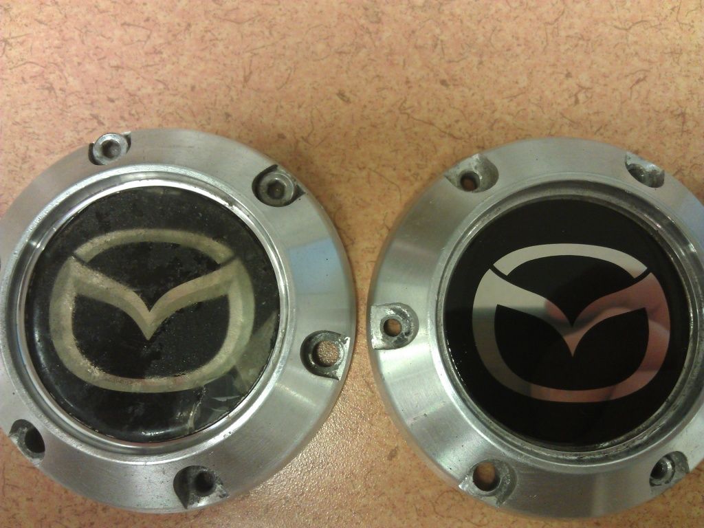

I recently got my hands on a set of the 17 inch Racing Harts that came on the speeds and the center caps all had the infamous damaged/faded/ratty emblems. I googled for about 2 hours to try to find a solution and found NONE. So I jumped on my catalog (I am a Mazda parts manager) and looked for a car with replaceable center cap emblems. I came upon the 97-98 Protege and found what I was looking for. They aren't quite as nice as the ones that came on the caps, but for $7.44 list/ea, I figured they were just fine. If anyone is interested, the PN is G14H-37-192.. although there appears to be 13 total left in the warehouses. I can get my hands on the remaining ones if anyone is interested, or you can go to your local dealer and give the parts guy the number. Anyway, here's the pic...
The one on the left is obviously the old one. The new one isn't as thick, but lays in the spot perfectly. NO ONE made the required 44mm emblem that I could find. Anyway, wanted to share because it seemed to be a common problem and no cheap way to fix it.
thats an awesome find! when i bought my mazdaspeed wheels they were missing 2 center caps and one was cracked just like the one above. i ended up buying 3 MP3 CCs.
