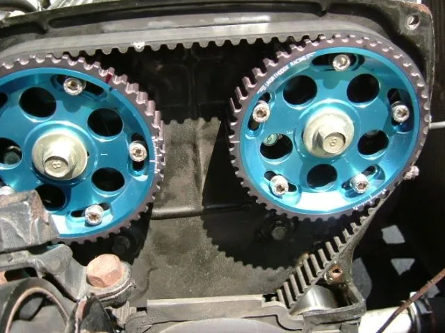

i havent dont those settings on mine actually. i have 0,0. those settings above apparently yield maximum power on the stock cams. they'd be pretty close to max power on the j-spec/mazdaspeed cams as well.
for me i need to retard my intake cam if anything i guess
I have UR Ultra TRs.....
