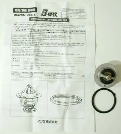

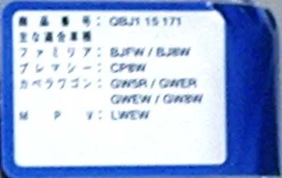

I just installed the MazdaSpeed low temp thermostat yesterday while I was doing my timing belt... this thermostat is designed to reduce the engine operating temperature so that it will less likely be heat soaked during hard driving while also being emissions legal (in Japan). This thermostat is very expensive (overpriced), it retails for 80 bucks in Japan!
The stock thermostat starts to open at 82 degrees celcius, while the ms one starts to open at 68 degrees celcius... a difference of 14 degrees!
The thermostat I installed was obviously QBJ1-15-171 since I have the FS engine. It is compatible with the FS, FP, K series, and RF diesel engines (both turbo and non-turbo). There's another thermostat MazdaSpeed sells that is compatible (part number QNB1-15-171, it is a bit cheaper... by 10 bucks) with the B series engines (they do not recommend using it with the B3 engine since it doesn't make all that much heat to begin with, so you'll end up overcooling it!), Z5, ZM, and ZL engines.
After I installed it, I did some data logging through the OBD-II port to see what the coolant temps are now at.... ambient temperature is about 35 degrees celcius today... the data logging starts from cold starting the engine and waiting for it to be in the, "operating temperature" range (temp gauge at middle), the coolant sensor is reading at a steady 75 degrees celcius even with some driving in the first 10 minutes of start up. This shows the thermostat is just at the threshold point (it's regulating the coolant temp to that level) while the coolant sensor is seeing 75 degrees at the hottest point of the cooling system. After waiting for the engine to be truely warmed up (through some highway cruising), the temperature peaks out to about 85 degrees at idle (with A/C on). Driving around streets, the temperature stays steady between 80 to 81 degrees. Highway cruising between 65-75mph results in a steady 83 degrees. Hard "spirited" driving bumps the coolant temperatures up to 87 degrees. Not bad!
So what is the real result? The engine bogs less now in the "spring" 95 degree fahrenheit texas heat, its making power at the upper RPM ranges like it should, and the engine does *not* run "too cold".

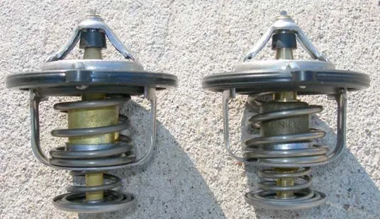

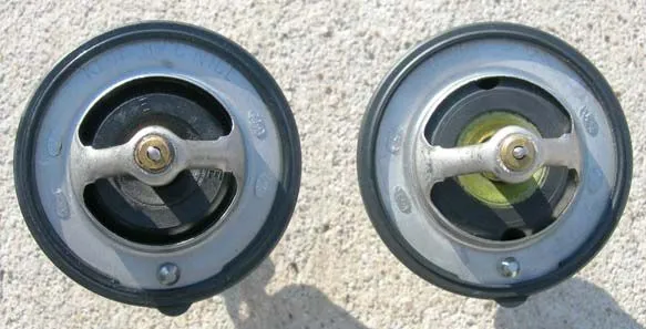

Here's a comparison between the stock thermostat and the ms one... you can see that there's more coils in the ms thermostat's springs, which means it will close more gradually than the stock one.
stock one is at the left, and ms one is at the right

on the ms thermostat, there are 2 notches on the sealing rubber that when the themostat is opened slightly, coolant flow will be increased, thus making the operating temperature lower.
