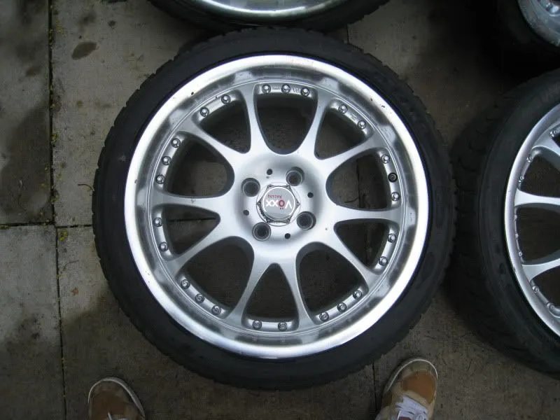

The wheel Bearing noise on the front right (drive wheel) I could hear it, but nobody else seemed to hear it. When I jacked the car up to check brakes, I couldn't feel any "shucking" when I yanked on the wheel but it rotated harder than expected. The wheel bearings were definitely due. I replaced the dust shields as well since you need the hub off anyway to replace them. Here's a pic of the same exact wheels I am putting on my "2". More pics in next day or two. Dan BTW what kind of stuff have you done with your "2"?
