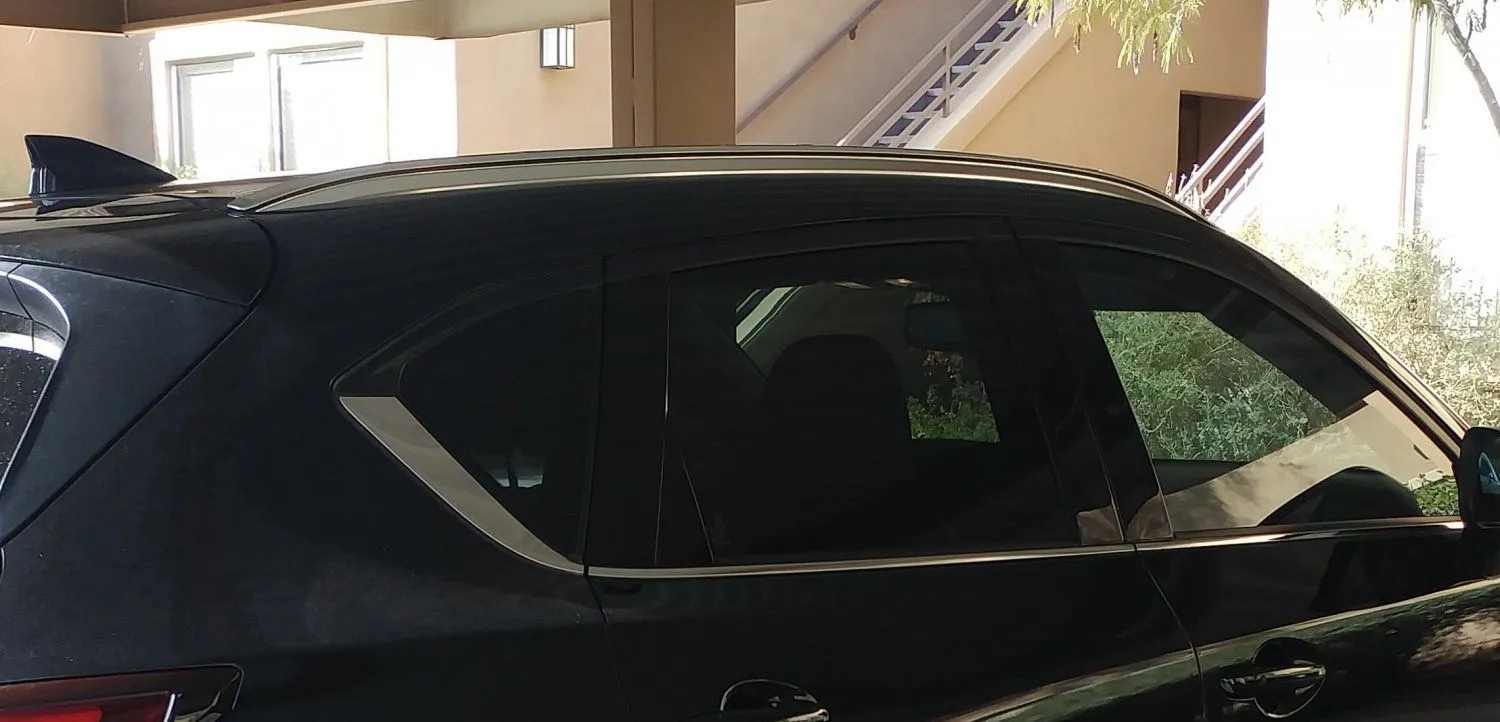

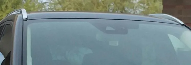

if you’ve got the Mazda rails, could you snap a pict? Thanks,
- Mark
CX5 GT
see if this helps. zoom in for better view.
2019 CX-5 GTR
and to further help you have options.
fitment issue
another photo:
2021 CX-5T AWD CE
Thanks for the pict and links. Yes, I think I need to go to a dealer and find a car on the lot with the rails and see if my clamp-on Thule cross bars can be mounted securely to the factory rails. I'm not optimistic as the clamps on my crossbar are very old school and designed for rails that are raised above the roof with a gap below. These aren't the exact ones I have, but they're similar:

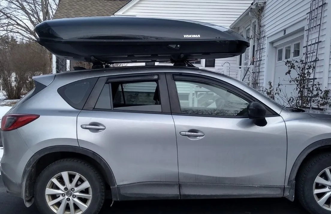

The perfect solution is pricy and permanent. Custom tracks drilled and riveted to the roof. Full adjustability, bunch of strength, clean looks and lower profile than OEM. Exact same tracks used for truck caps but rivets or plusnuts for sheetmetal roofs. http://assets.yakima.com/sku/instructions/8001126/1
I tracked my CX5 a few weeks after purchase. I've drilled wagons, minivans, trucks. Not for everyone and not for leased vehicles. 8 years old almost 200k miles.
Canoe and 2 paddleboards, rooftop tent, box w bikes all kinds of different combos. 36" is the ideal barspread in most cases but longer is better for boats/lumber

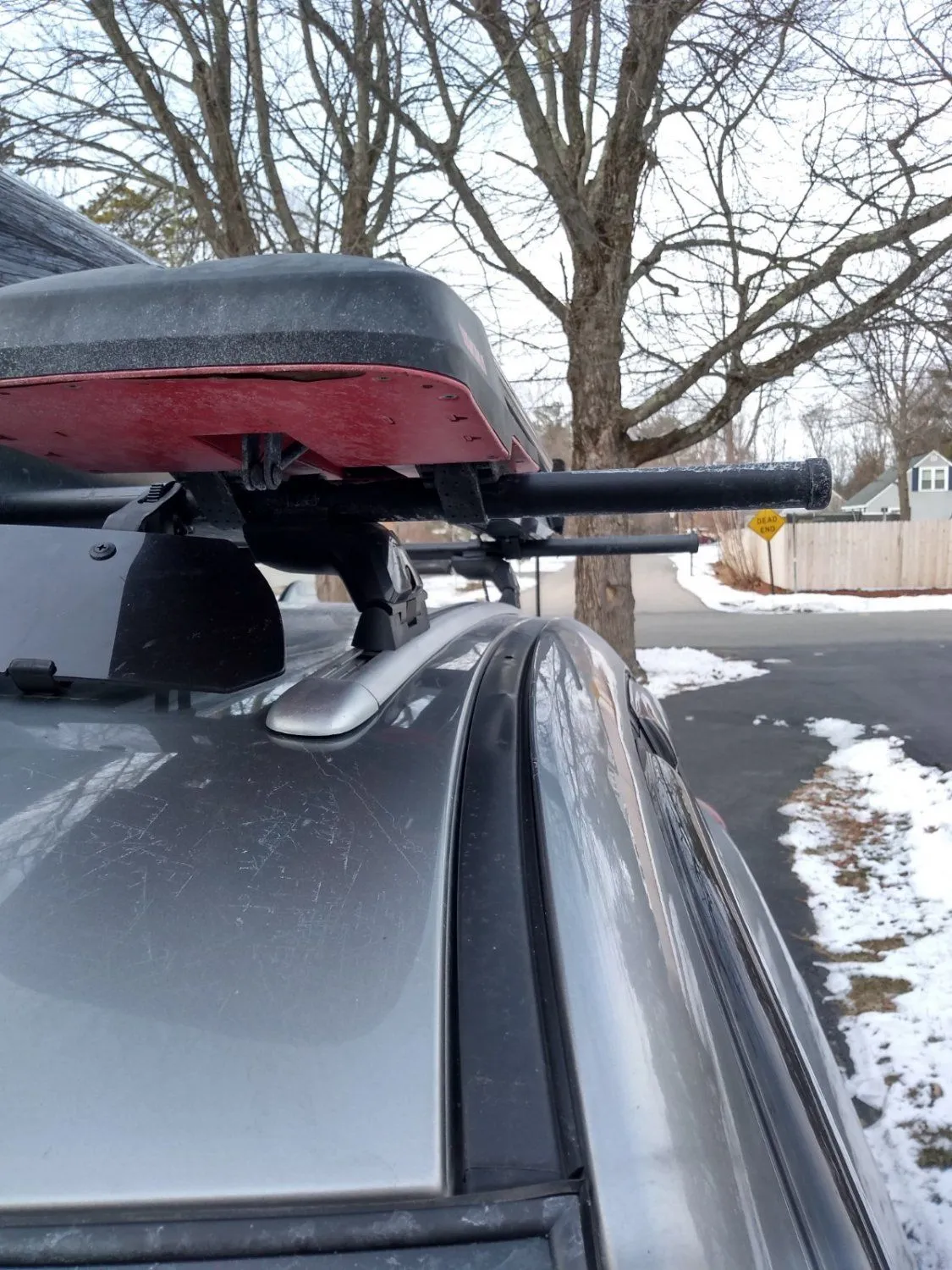

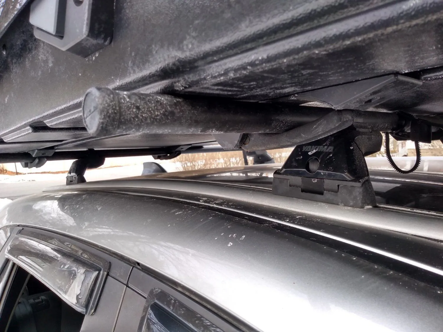

I used the Whispbar track with Yakima PlusNuts instead of rivets. Approx 56" long starting about a foot from the windshield and going right to the hatch.
The Yakima tracks (same as Thule other than hardware) have greater flexibility to fit curved rooflines. The Whispbar track wouldn't full seat at the ends in my case.
I would recommend an experienced installer like RackAttack or RackOutfitters to do this are there are professional tools and unique methods that make this easier, cleaner and more reliable. I did also custom paint these tracks to match which came out much better than I anticipated.
I only use Yakima. I've used 48" and 58" roundbars, S Jetstream and Med Core bars. Just swapped back to 58" roundbars so I could put the Med Core bars on my partner's Acadia. Jetstream bars are the strongest and quietest and are on my daughter's Accord.
The crossbars are set at 36" and I can open the rear hatch with no interference from the box which is a Showcase 20. The rear bar could go back another 12 inches. Front could go about 3 more inches forward. Tracks aren't parallel to each other but are approx 1" inboard of the roof seam/trim strip.
