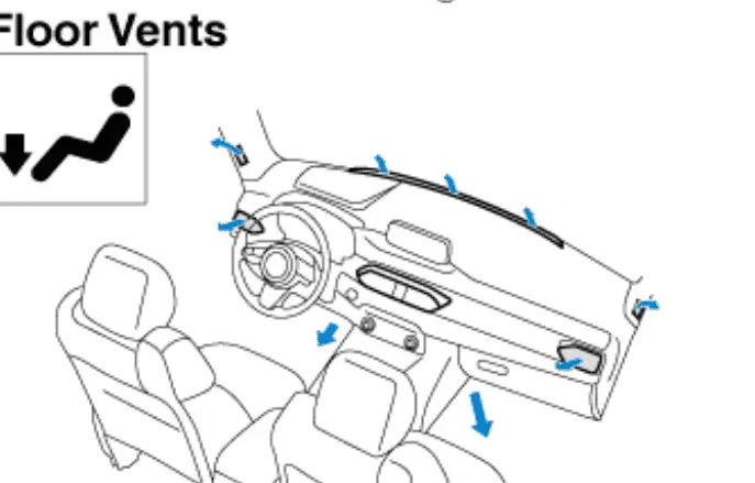

In my CX5, it does the same thing, however there is still some air going to the defrost vents and this is further confirmed by the owner's manual confirming. When the floor setting is selected, air actually comes out of the floor AND the defrost vents. I suspect it's the same with the CX-9 but that's something you may want to check.
