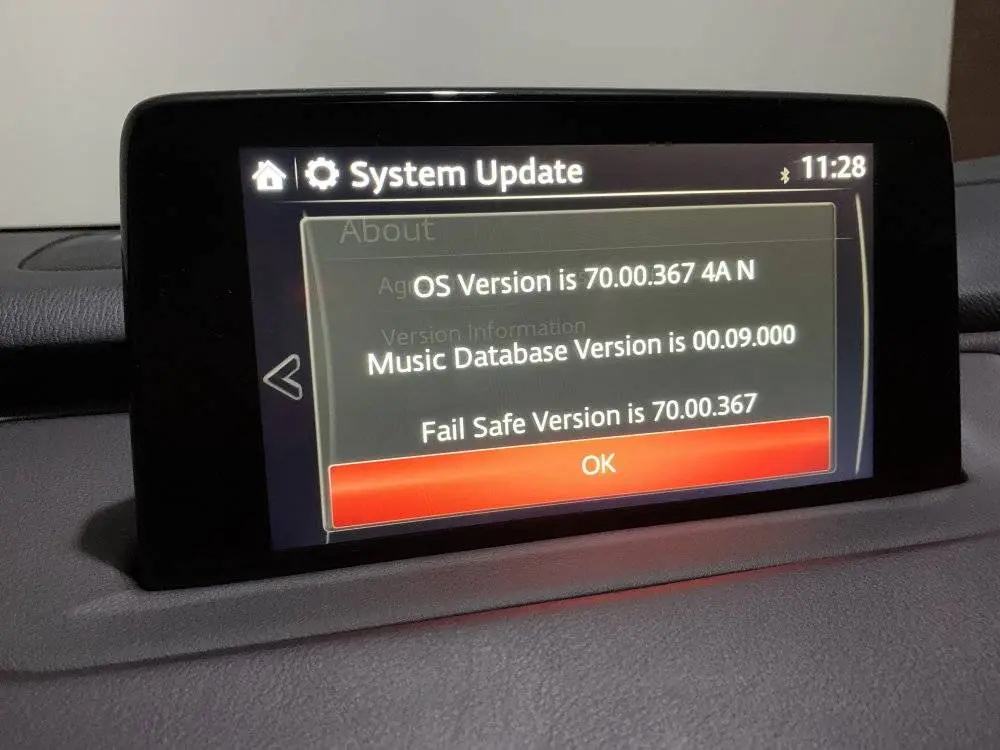

On another thought, since I recently got Apple Carplay installed, is there a possibility that they installed firmware of CX-5 instead of CX-9 which has rendered the tweeters unusable. Or is the firmware generic for all MZD Connect ? Here is the snapshot of currently installed OS version...
