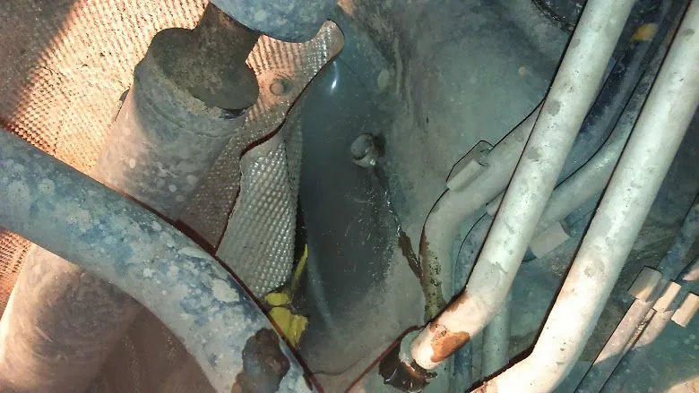

First I would like to thank all of the people who take the time to post to this site, your information has been invaluable. I own a 2008 Mazda CX-9 and have recently had the problem with the evaporator on the A/C unit not draining properly and backing up into the blower housing. I spoke with the people at my Mazda dealership and they told me that it would cost $99 if it was easy to unclog and $199 if it was difficult. The reality is that the evaporator drain exit is exactly where other people have said, under the vehicle on the driver side under the corner of the metalic heat barrier, that silver looking piece that is held in place by 4 bolts. It is not necessary to loosen any of the bolts just peel the corner of the heat barrier down, if you are under the vehicle with your head facing the engine compartment and your legs pointed toward the the rear axle it is on your right and on the part of the barrier closest to the engine. Once you have peeled back the corner of the barrier you will see a white plastic tube protruding from the body about the size of a quarter, this is the drain. To unclog it I suggest using either a compressor to force air into it, or better yet a wet dry vac with perhaps a piece of gardenhose attached to the end of the suction hose with ducttape. Which ever you use place it over the white plastic tube and let it rip. Beware as there will be a lot of water coming out of the drain tube once unclogged, but the whole procedure shouldn't take more than 1/2 an hour. Thanks everybody and good luck!
Good info. Here is a picture

I like when a fix works just like it is explained. Thanks folks. I wish I would have found the location sooner to shorten my day but it still saved me a trip to the mechanic.
I used the 12vlt pump, hit it with the air once to get a slow trail of water and then hit it again and it dropped close to a gallon I'd guess.
