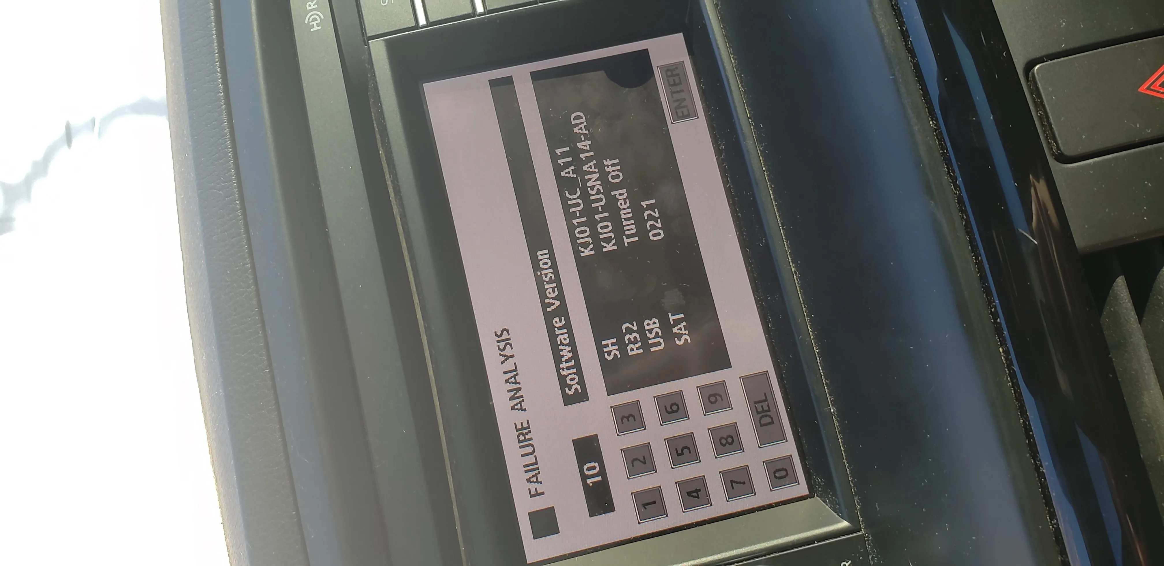

Do you know what firmware version we have on the 15' CX-5's? There's no way for me to even check on the head unit, not anywhere in the settings.

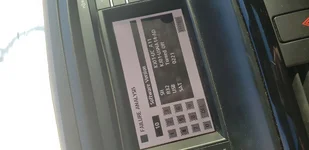

Oh okay thanks for the great link! It's hard to find stuff on this model, I am still trying to find a way to mod my system with Mazda tweaks. Do you know what this picture means?
I'm just starting out with mazda tweaks so could be wrong, (just bought a 2016 cx-5) but from what I understand mazda tweaks only works on the 2016 and newer cx-5. You have to have a touch screen model with no buttons on the side (all the physical buttons are next to the cup holder in the 2016 and later). It is possible that some 2015 versions of other models had the updated radio (like the mazda 3 or something) but it only applies to the radios with the newer look / ability to run apps.
Yeah I looked up the interior pics of the various models, and the new radio style that has no physical buttons was added to the 2014 mazda 3, 2015 miata, 2016 cx-5/cx-9 / mazda 6
So looks like both of yall are out of luck.
