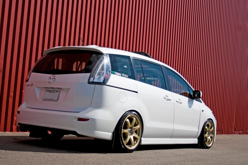

Yes i'm running 8mm on stock "bolts", and i'm also running a pretty agressive set-up for a 5.
18"x8.5"
offset 48
+ 8mm spacers
(EDIT) with a 2 + inches drop :D:D:D
This is what it's look like.
***Believe me, there's no problem running a set of Mazda 6 OEM rims on a 5 lol.***

It looks awsome! Do you have hub centering spacers? Vibrations? Sorry for all questions...
VenomDesign, are you running the spacer to clear the calipers or is it for looks? It looks pretty dope, I'm hoping to get something a bit more aggressive and more tire stretch once I settle on a new wheel setup.

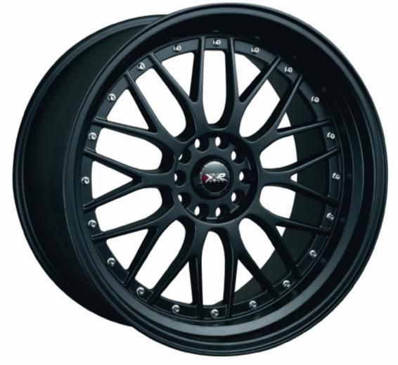

Was Kinda thinkin of the 521's in 18x8.5 +40. XXR is a sponsor on my team so they're pretty cheap

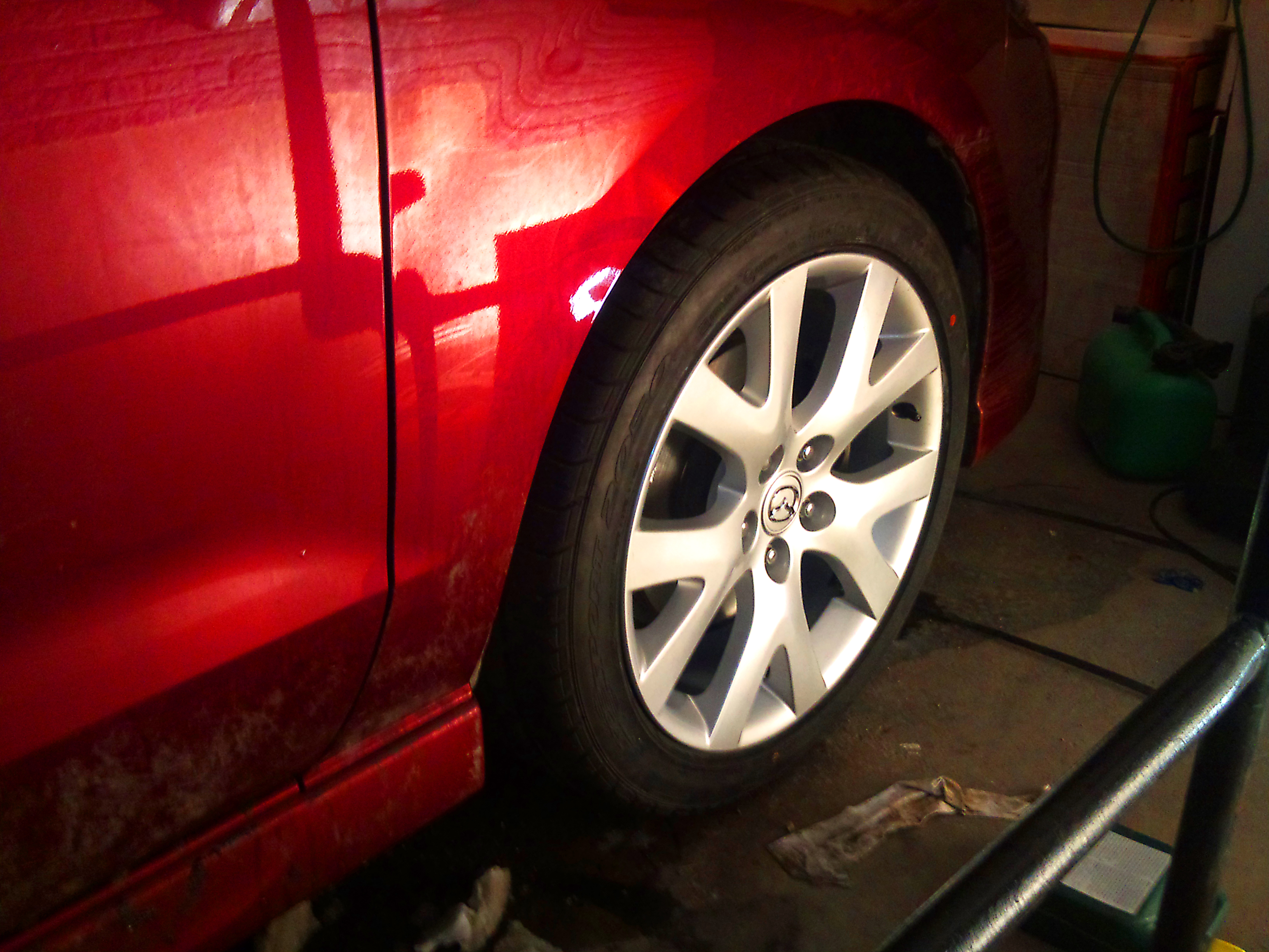

For those of you who can stand a picture of a VERY dirty car (just drove almost 600 km to get the new wheels) I can tell you that the wheels fitted bolt on! No spacers needed. It's tight (about 4-5 mm) to the strut but I think it should work fine. The only thing I'm worried about is tire rubbing at the front/inside of the tire when it's turned all the way to one side. When turning fully left the inside of the right tire is very close to the front/inside of the wheelhouse if you understand what I mean. The rim has 60 offset so the wheel gets rather deep in the wheelhouse. It's winter here now so I cant test drive until next year. Do I have to worry about anything more now or should I just long for springtime to put my new wheels on a clean polished car?
The positive thing is that the wheel don't extend more than 5 mm on the outside compared to stock 17" wheels. Looks really good (it's hard to see at the picture).
Well here is the picture (on a dirty car...):
