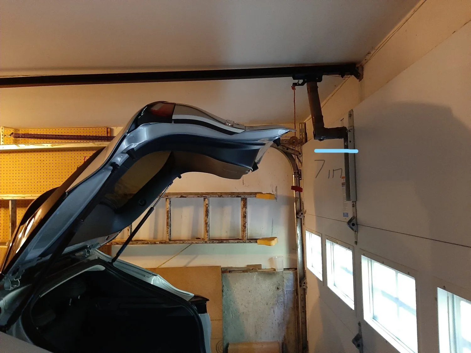

Thanks for all the suggestions: Here's 2 pictures of my issue: The bracket to the garage door opener extends 7 inches down from the garage door. So I need 7+ inches of clearance for the garage door to open or close with the liftgate open. The open liftgate is only 2.5 inches from the garage door when open. The easy answer is "Don't operate the garage door with the lift gate open" But sooner or later, a mistake will happen. I'm thinking about the string approach but I've got to find something to fasten to.

I'm not a garage door installer, I've only helped install one garage door opener ever, but is it possible to unbolt and "flip" the part wrapped in insulation? So that instead of an "L", it looks like a "7"? That would give you more clearance, but I don't know if it would affect the operation of the garage door. I suppose you could also replace the "L" with a straight piece, but then you'd have to source that piece from somewhere else. Maybe call the garage door manufacturer to be sure before attempting, lol.

I think that L may be required for the arm to clear the top of the door when it is horizontal. ( the track is above the door and the arm has to reach under it). Maybe sone bracket are designed to pull the door from the top, But like sm1ke says a garage place may be able to help with that.
