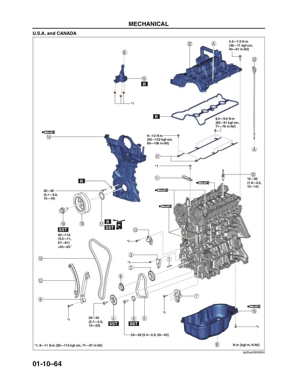

Sealant in areas shown here?
18 Mazda CX5 AW
I would really like to see if you can twist a 2.0 or 2.5 Skyactiv engine valve cover seal and try to install it. ;)
And considering the type of valve covers and engine 20 years ago you may not have the experience yet giving advice on the MAZDA Skyactiv engine?

Off topic, but I noticed an error in that workshop manual page a couple posts above. For each fastener, the third torque value is supposed to be in-lbf, but for the spark plugs, the value 12-14 is ft-lbf. It's unlikely anybody would actually torque a spark plug to 12-14 in-lbf (that would be finger-tight), but to be on the safe side I thought I should point it out. This kind of error in a workshop manual is unnerving. It makes me wonder how many nonobvious errors there are.
It's not an error. Look at the bottom right corner of the page. The unlabeled 3rd torque value is always in ft lbs unless in-lbs is specified

Um did you read the first post. Or any of my posts? The OP has a 2019 . MAZDA changed the valve cover design that reenforces the area that was a small problem with previous engine. :rolleyes:

For other who are genuinely curious and MR madar go look at the first picture I posed of the edge of a MAZDA valve cover and then go look at your valve cover in that same area. :cool:
I would post yet another picture but in this case I would rather you all go see for your own. ;)
