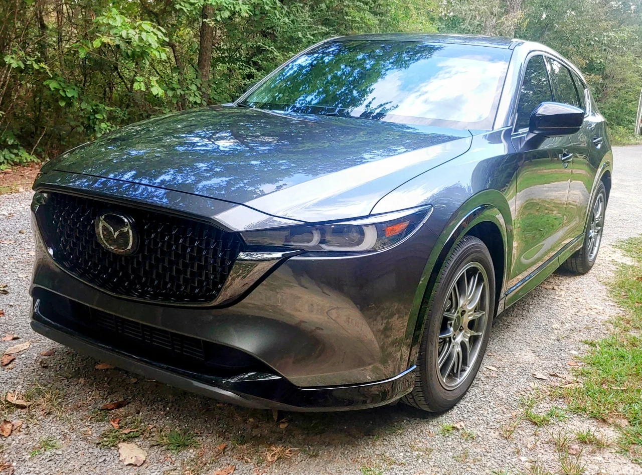

Here is our 2024 turbo we took last weekend to the mountains.
It's lowered 1.5" front and 1.75" rear with BC Racing RC coilovers, Megan front and rear sway bars, Prothan urethane sway bar bushings. 19" Enricii spun forged wheels. It still has factory A36 tires. Also changed out squeaking front brakes to high performance pads with drilled and slotted rotors.
We are in our 70s and not looking for a Tuner ride. These BC coil overs give us fine height adjustment and the ride quality we like. The car was a joy to drive on the twisty mountain roads and rock solid on the interstate highways.
I've made a few hard braking and turning to avoid an accident. This suspension setup is a dream under these conditions.
I installed all of the above parts. The front sway bar was the biggest challenge until I learned the trick.
This 2.5l turbo averaged 32.6 mpg over the weekend, including daily trips of less than 3 miles. Tuned Ecu and a few of my own engine mods. Not a hot rod. More like a sport mini SUV.

Even with just 1.75" drop, Inkea wheels and tint women check out our CX 5 in the parking lots. I was surprised anyone would notice, especially women.
