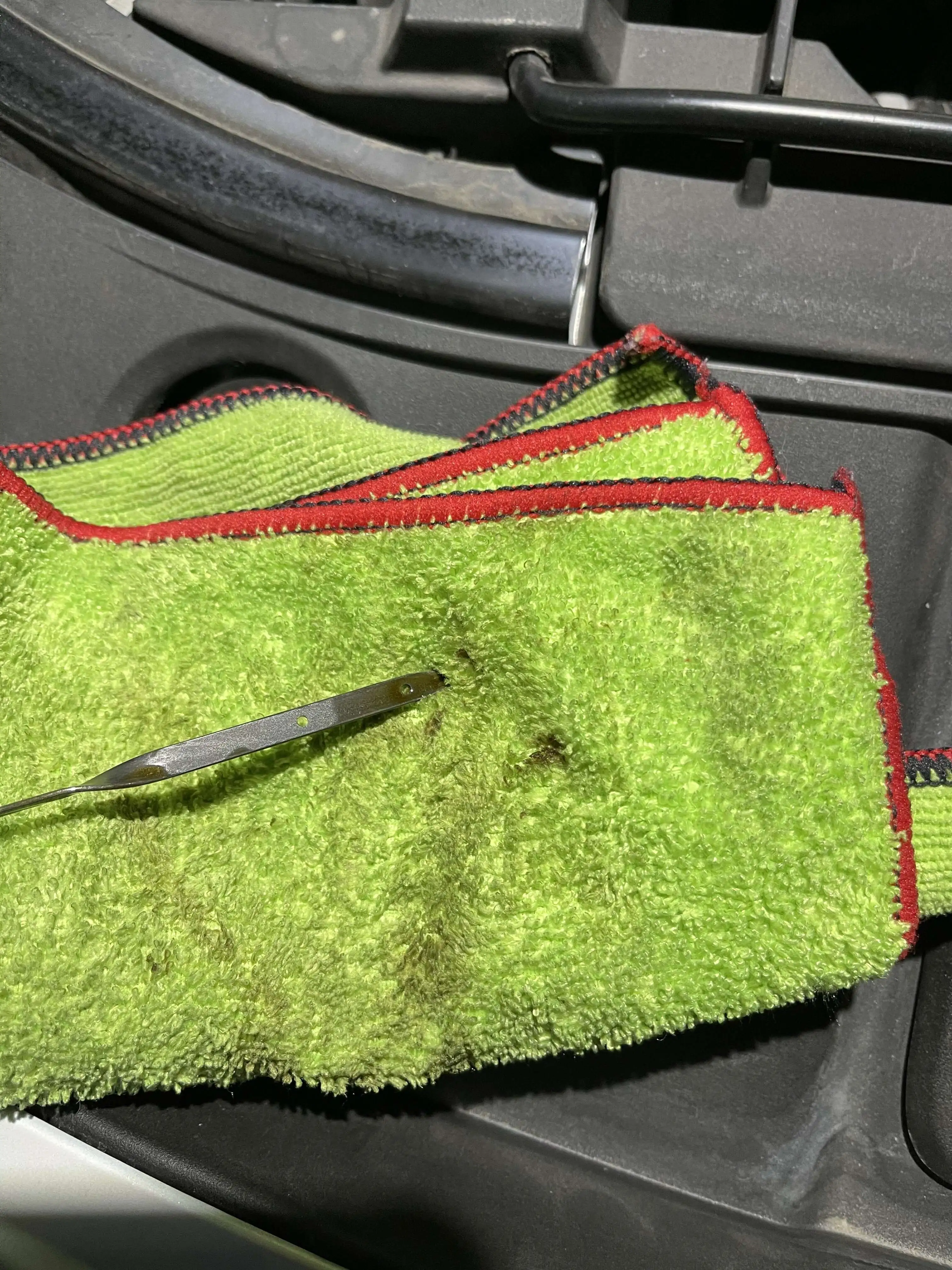

(Issue 1) So today when I come home from a 300 miles trip. My low oil light comes on. So I waited for 10 minutes to check my oil level and it was not very low. Should I add oil to it or something else is wrong. I have been to the dealership for low oil light issue but they said there is no fix for it and they did replace an oil sending unit. If I'm not mistaken where my oil is at is not low? My last oil change is about 4000 miles ago. I did wipe it off and reinserted it a few times and the car is on level ground (by eye) <let me know if the picture did not post correctly>.

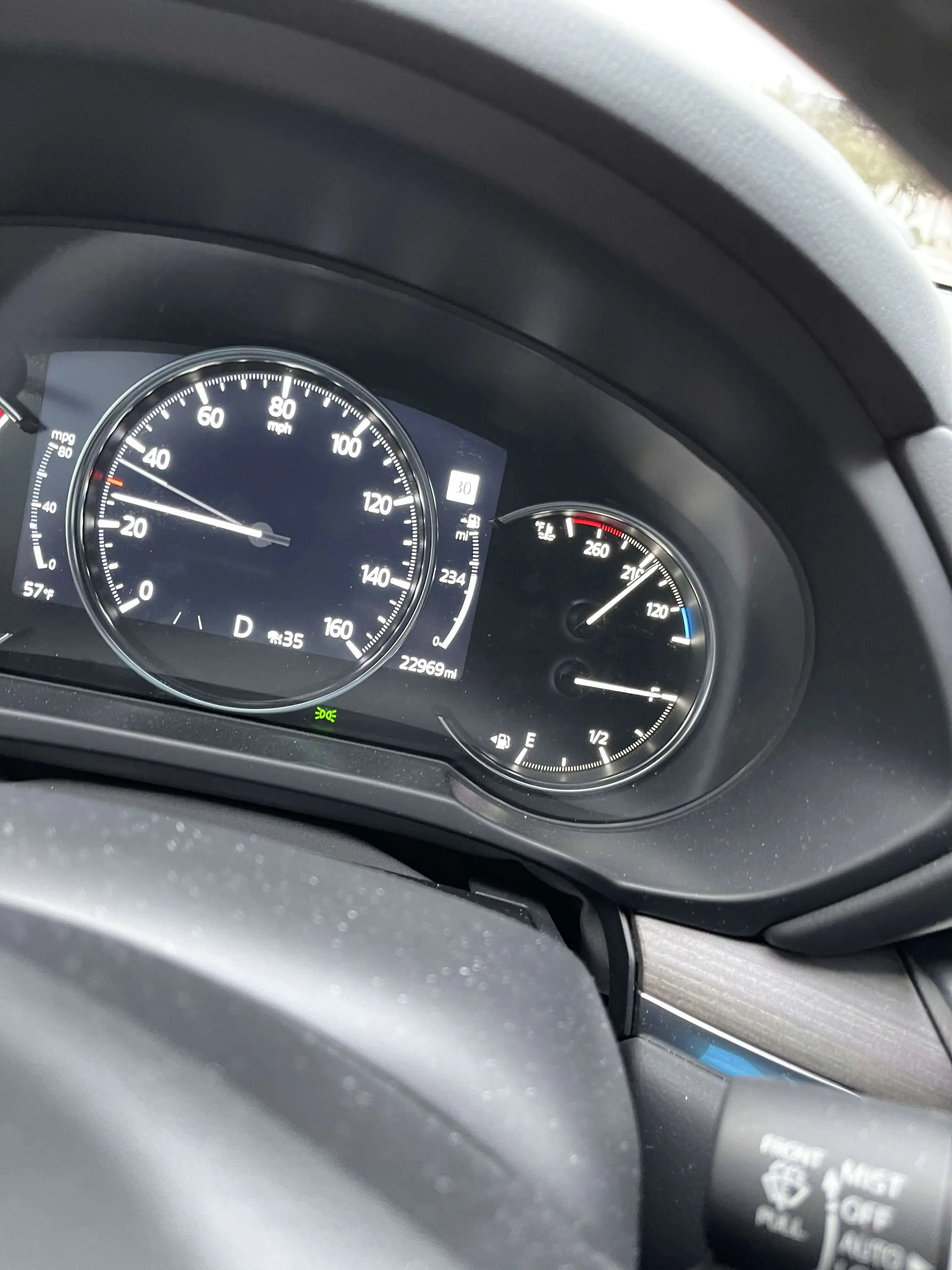

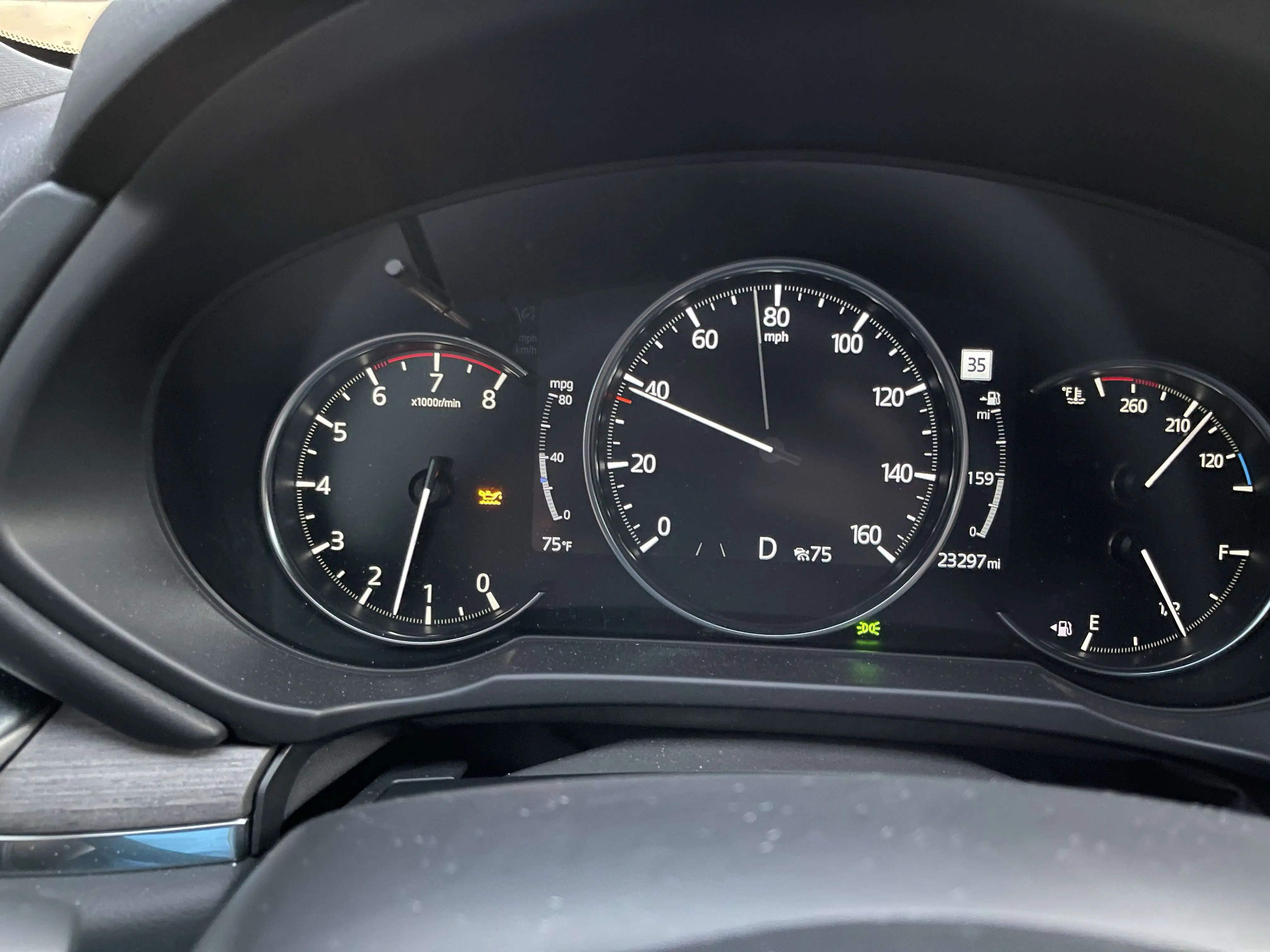

(issue 2) 2 days ago before the trip, I went to go top off my gas it was not empty I only added 3gal till it clipped. I notice that the digital gas gauge didn't fuel up to max but the analog gas gauge did show up max. This is the first time that I happened. Is there something wrong with it? The second time I fuel up the tank I did notice they are a little closer but still off by about 1/5 of the tank.

the light should absolutely not be coming on with the oil that high. I would stop by the dealer so they can take a look at it. and show them picture of the dipstick as well
Yeah the oil light should not be coming on that early. Does it go away if you add more oil? Probably a sensor issue.
I think the digital gauge is a range indicator. The estimated range is based on your driving, so maybe it doesn't appear full because of the different driving habits between your 300mi trip and your normal driving?
went to the dealer with the same issue last time and they have already replaced the oil sending unit sensor. This time I went in they told me it's low. "it needs to be at the max hole" I never see an engine requiring the oil at max all the time.
BS, and not consistent with owner's manual.
Maybe yours needs to be at max to hide the problem.
