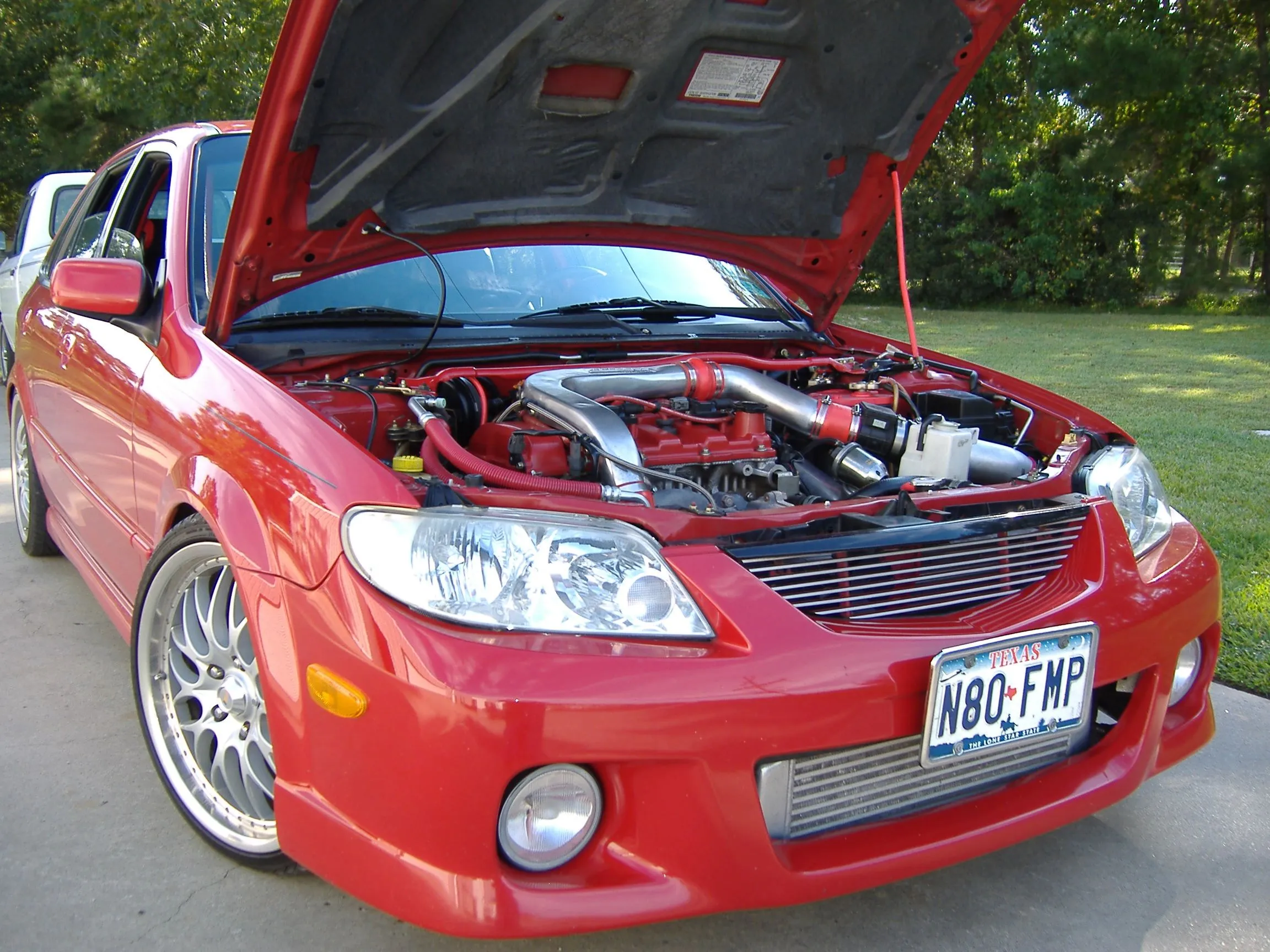

I think you would be better off with a turbo kit. My P5 will be paid off at income tax. You can search and see that most have upgraded their Mazdaspeed with parts most Turbo kits will come with. Fuel management hardpipes and FMIC and bigger turbo +much more power to start with.
I recommend you visit www.Hiboost.com like I did. I have around 65k on my Hiboost kit and couldn't be happier!!

Turbo kit
I was looking into a kit ,they go around 3500 plus the install, I was trading mine and waht I would pay would be around $3000 for the MSP
