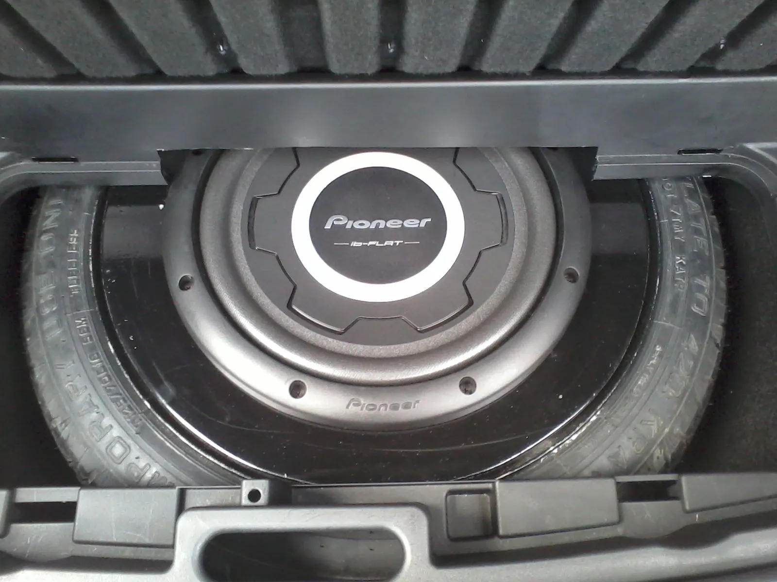

spair tire speaker box
it seems a constant issue in these small cars, wanting more bass and not taking up any storage space. I have a 5 and it has no storage, so any extra room is valueable. I came up with this as a solution, it needed a little modification but nothing major. IMG_20130505_102625.jpg IMG_20130505_102625.jpg

it seems a constant issue in these small cars, wanting more bass and not taking up any storage space. I have a 5 and it has no storage, so any extra room is valueable. I came up with this as a solution, it needed a little modification but nothing major. View attachment 202879 View attachment 202879
Do you have more info on that? I am looking for similar solution.
