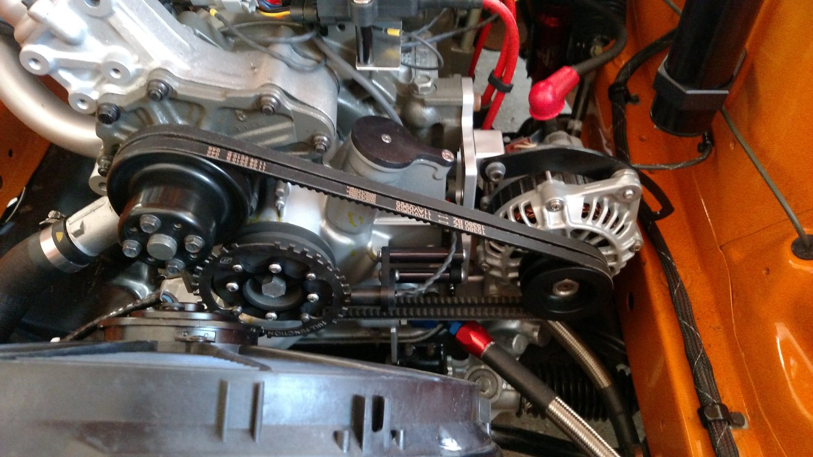

Trying a different image hosting service. Let's see if this works. I made some small changes. First I swapped in an underdrive alternator pulley.
It doesn't really need to be underdriven but I didn't like that my other one had a different belt spacing. I was afraid that would lead to excessive wear that could cause a failure at some point. I've also been playing around with the MAP sensor placement. I've got it about as high as possible in the engine bay.

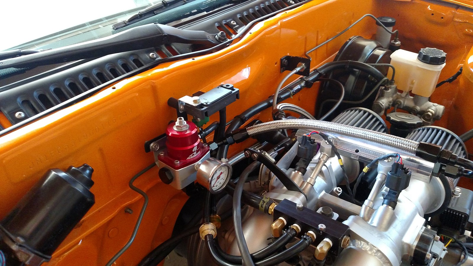

Somehow, I'm getting a lot of reversion in the intake system. Even though the vacuum manifold is well above the ports on the intake I'm still getting fuel/oil in the vacuum lines. So far the little inline filters and check valve is keeping that out of the fuel regulator, MAP sensor, and brake booster but at some point I'm going to need to find a better way. I'm thinking about rigging up a filter that usually intended for air tools. Kind of like a catch can for the vacuum system.

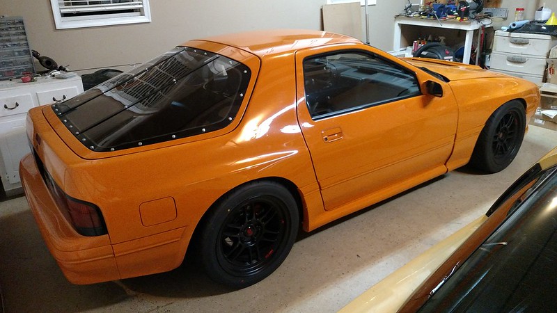

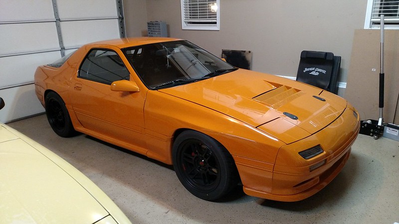

I realized I don't have any decent shots of the car in its finished form. I took a couple crappy pics in the garage last night.
magnumP5
'86 RX-7 Base, '79 RX-7 GS
Damn that thing is bright! Looks killer
Thanks, the fluorescent lighting makes it appear lighter than it really is. Someone pointed out it looks like Tennessee orange and that's definitely not the case.
Figured I would come over here and see how your build was going. Didn’t realize how similar our builds were! Your setup is exactly what I’m considering for my FB (if I ever finish the REPU).
I tried to research the fuel in the vacuum line issue but couldn’t come up with any suggestions other than possibly a leaking FPR. I don’t have a vacuum line on mine and yours looks brand new too so i doubt that is an issue.
The only thing I can think of is that it is simply related to the pulses of the rotors allowing a small amount of gassy air to pass between the two intake runners via the vacuum manifold, and from there, the gas can eventually condense in areas that won’t dribble back down to the intake. In your case, maybe tilting the two lines to the MAP and FPR upward so any liquid will always roll back into the manifold, and then back down into the intake. I can’t tell if those hoses always maintain an upward path but if they don’t, give that a try and check back after a few hundred miles to see if the amount of fuel left over has improved. Another option could be to only take vacuum readings from a single throttle body. On my truck, the brake booster was only connected to the rear rotor secondary port. On the later gen RX7s, I believe vacuum is read before the separate runners split so you don’t have a situation where gas filled air can move between runners.
I too thought that it might be the FPR since there is significantly less in the MAP sensor line. However, the line after the filter is dry so it's definitely coming from the engine side. It's hard to tell but the vacuum lines all have at least a slight upward angle to them. I'm going to mess with them a little more when I replace the filters in the near future. I'll have to try the single throttle source. Use one for the brake booster and the other for the FPR and MAP. I had just assumed I would have an unstable vacuum single off a single rotor. If anything, it would be interesting to see if I'm getting different numbers from each rotor.

If you are trying to do a VE tune instead of TPS you will need the Map connected to both. No way around that, however the brake booster and FPR aren’t as sensitive to that. I say, get it dialed in, drain the hoses, then rev the piss out of the motor and cut the ignition every time you shut it off. That should help clear out the lines and ensure fuel isn’t resting in the intake.
magnumP5
Yeah, this is what I was just thinking. I'm tuning by VE with a MAP reference. The Haltech actually can tune by VE with TPS as well but I'm not doing that anymore. If the MAP sensor is getting a signal from both rotors then the FPR and brake booster are a part of that same system even if they are only drawing from, say, the rear rotor. No matter what both throttle bodies will be connected via the MAP sensor lines.
I don't know if it's related or not but my crankcase vent was plugged for the first 600 miles. I don't have any kind of forced evacuation system. It's just a catch can connected to the oil filler tube via some fuel line, which was blocked with a plug I had put in place when I pulled the motor back in August. Apparently I forgot to take it out.
