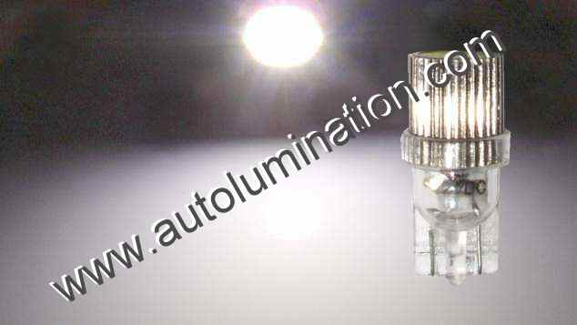

I can help you out.. The type of license plate lights you want are below. They are brighter than those found on the new Lexus:
Make sure you order the one with the heatsink at the very bottom of this page
http://autolumination.com/194.htm

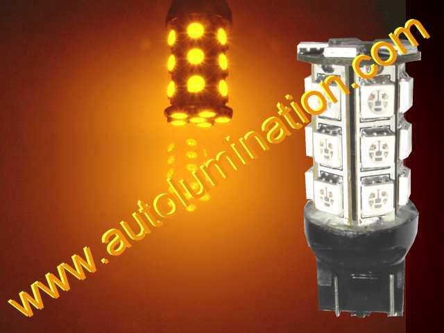

For your front turn signals, you will need these below with load resistors. I use them in my truck and they work well, even during the day:
24 High Powered Wide Angle SMT LEDS
They also have a combo White/Amber towards the bottom although its not as bright.
