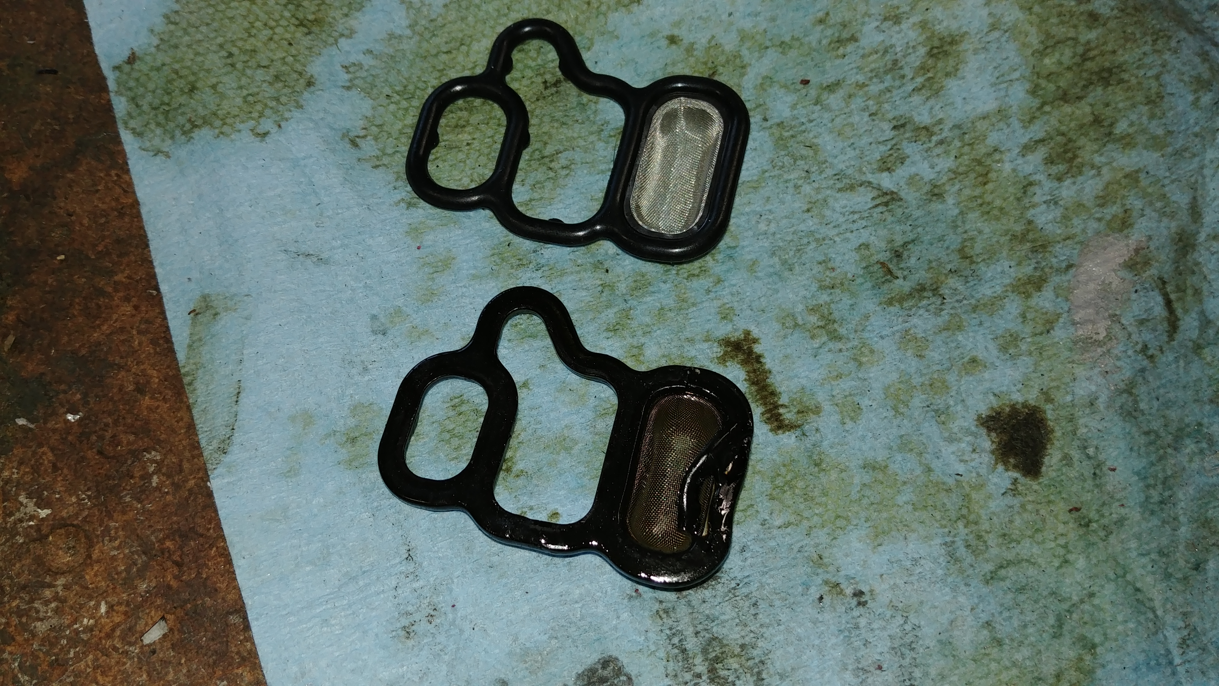

Back to the engine: got the oiling & timing system buttoned up for the time being. It looks pretty scabby on the outside (despite my best efforts to clean it...this engine needs a hot tank BADLY), but it's clean of oil and grease, and all the important bits were cleaned up and installed with new seals and O-rings where needed (VTC actuator, VTEC solenoid, the 'blanking' (?) plate on the intake side, Crank sensor, etc). The VTEC gasket was absolutely boogered, for example.

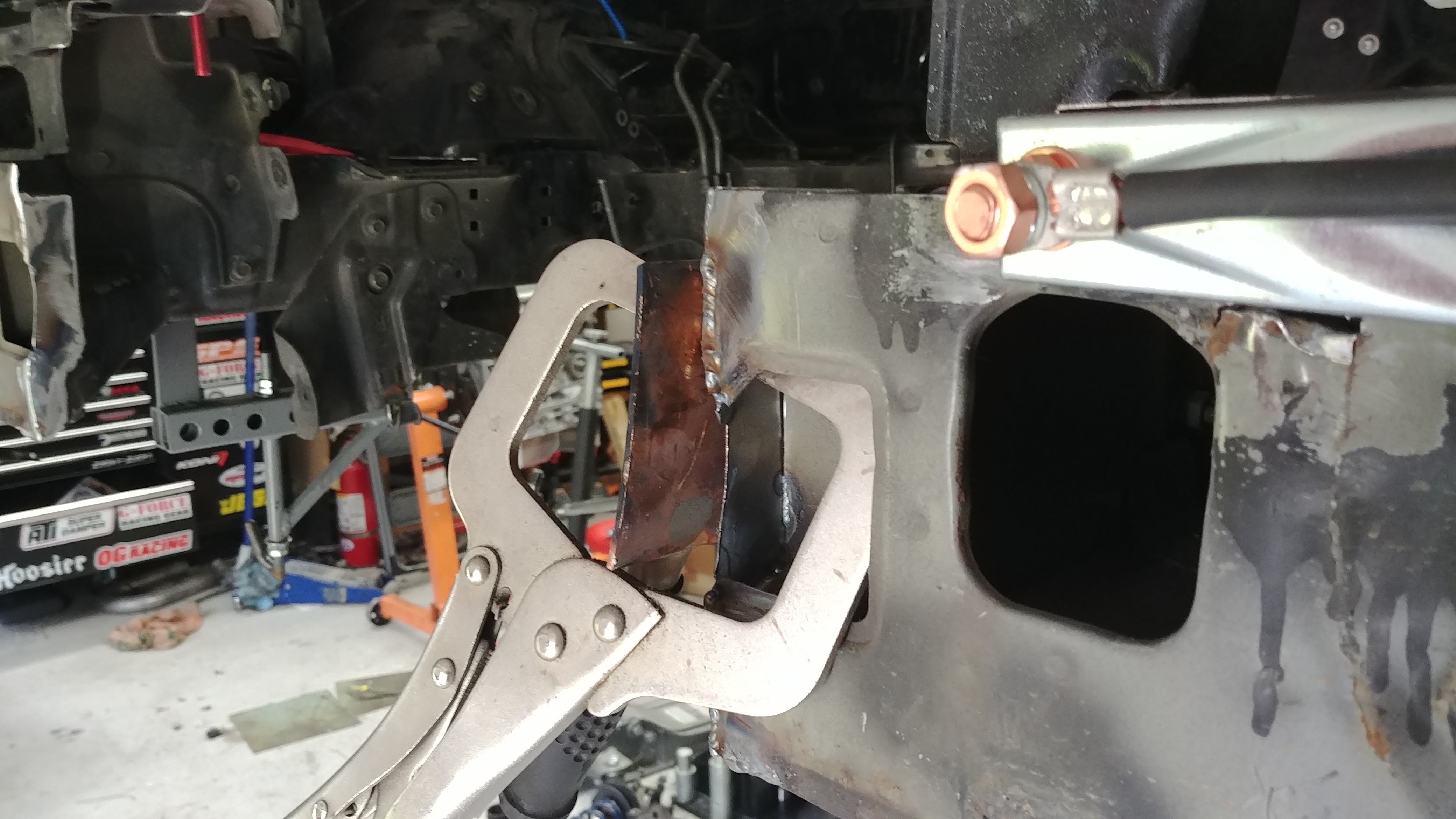

I got the ends of the frame rails where I cut out the bumper bar boxed back in, for both strength and safety working around that area.
MIG welding thin, old sheet metal with .030 wire is a pain in the ass but I made it work. I need to get a bigger piece of copper to use as a heat sink for stuff like this, but the little Harbor Freight copper spoon did the job.
And of course, a little "grinder and paint make me the welder I ain't" to complete the look.

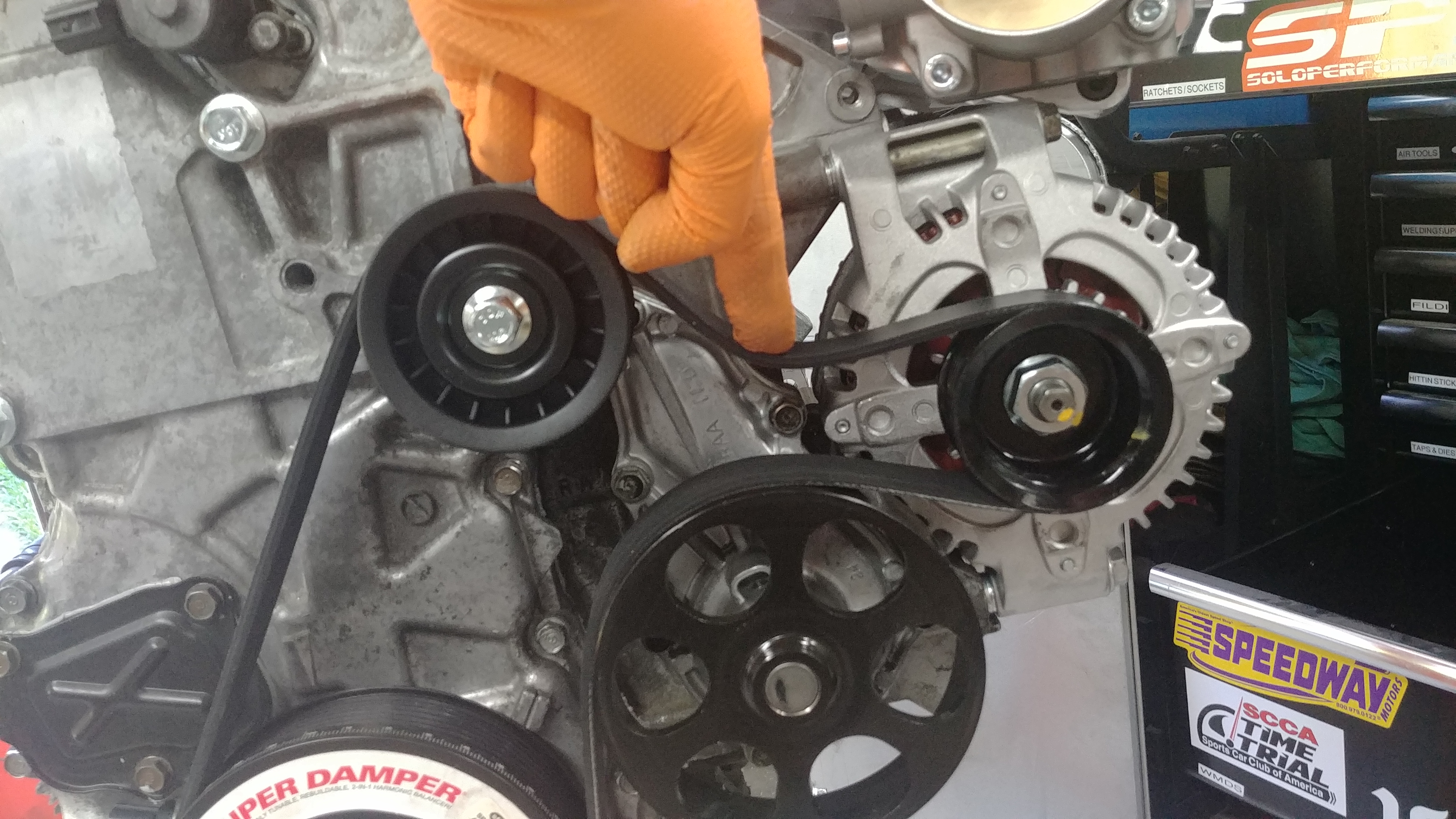

As is usual with non-standard builds using non-standard parts, it's a matter of working through 1 small problem after another. The KMiata swap is likely no problem if you use all stock Honda parts, but throwing oddball stuff into the mix tends to have knock on effects.
Case in point: Water pump and alternator belt tensioning. They do not use a tensioner pulley, but they add an idler pulley, and you shim the alternator with a washer or 2 on the bolts to tension the belt. Using a stock crank pulley, they send a belt that's the correct length for that to work fine.
An ATI SuperDamper, however, is a smaller diameter than stock, so that belt won't work.
I reached out to KMiata and it turns out they run that pulley on one of their race cars, and have a smaller belt recommendation (a 6PK1035. Apparently they don't make 7 rib belts short enough so you've got to run a 6-rib).
After getting that belt in, it was a lot better but the provided washers weren't enough to tension the belt.
So I went and got a few more M8 washers. I ended putting 3 washers under each bolt, then attaching the idler pulley. Even with that it was still a little looser than I like, so I cut a notch into another washer so it's a C-shape, and used a pry-bar to space the alternator out enough that I could put that 4th washer over the top bolt. MUCH better.

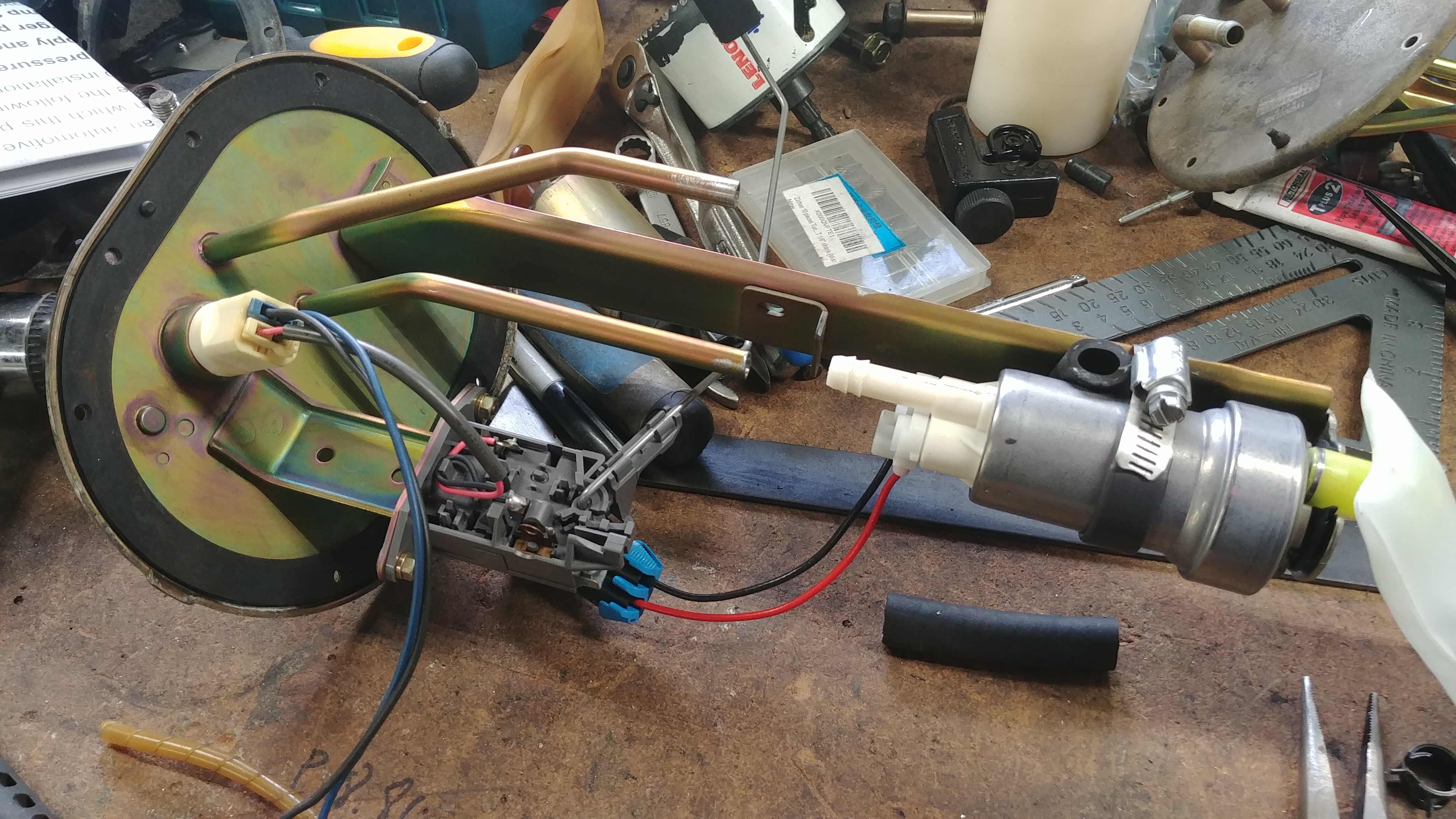

This is a Walbro 450 that's going in. This The only thing I think I want to do different at this point is add another worm clamp to make sure it stays put, and extend the return tube with some rubber line.
I'm swapping to an NB sender because the ends above the tank are SAE quick connects and much MUCH easier to adapt to AN.
There was some question if the NB sender would fit in the NA tank. I have a feeling the issue is the extra width from the stock NB fuel pressure regulator that would sit on the opposite side of the pump, adding a lot of width to the 'column' that's fed in, because once all that's removed it slid right in.
I also needed to shorten the feed hard-line from the pump to fit the taller Walbro, and cut off the fitting for the return line to the pressure reg.
