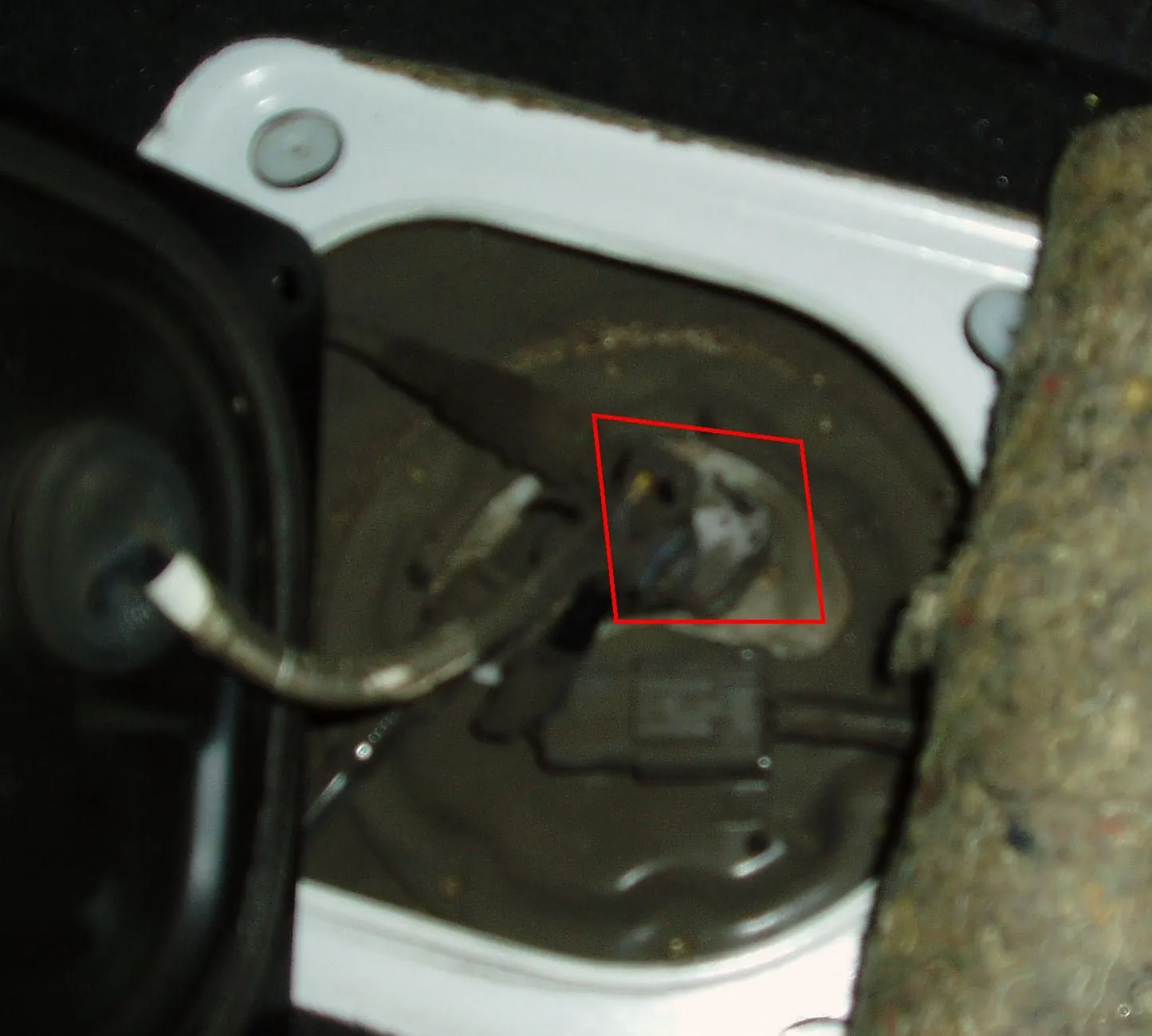

I want to make a Kill Switch for my car, but I don't know what wire to splice this into to cut power to my fuel pump.
I have about 10ft of 16Ga speaker wire connected to a simple toggle switch.
Can anyone please tell me how to hook this up?
Le me sheepishly say taht I discovered where this wire runs oneday entirely by accident while doing somehting that's a BIG no-no... FIrst off it's in the cluster of wires that runs down the center "tunnel" on the driver's side. I discovered this while attempting to simply poke a small hole through my carpet to tuck in an amp remote wire. knife through carpet blind (BIG NO NO) spark, car wouldn't start.... fortunately after 3hrs of panic I managed to re-wrap the wire and then located the fuelpump fuse under the hood, and somehow managed to find a spare weird little bastard at 2am.
Asfor which one exactly, couldn't tell you, but if you pop up your rear seat it should become obvious pretty fast,
Bump
I tried testing the leads with a multimeter to see which ones got power when the ignition turned on. all I could find was the white and black w/ pink line wire. I tried both, but the car still started. what gives, am I using the wrong plug? I'm using the plug thats connected directly on top of the fuel pump (I marked it with red)
Anyone have any Ideas or suggestions?

The switch should work on an aftermarket pump, just figure out which wire is the power wire and place the switch between there. Now you can place it anywhere in your car.
