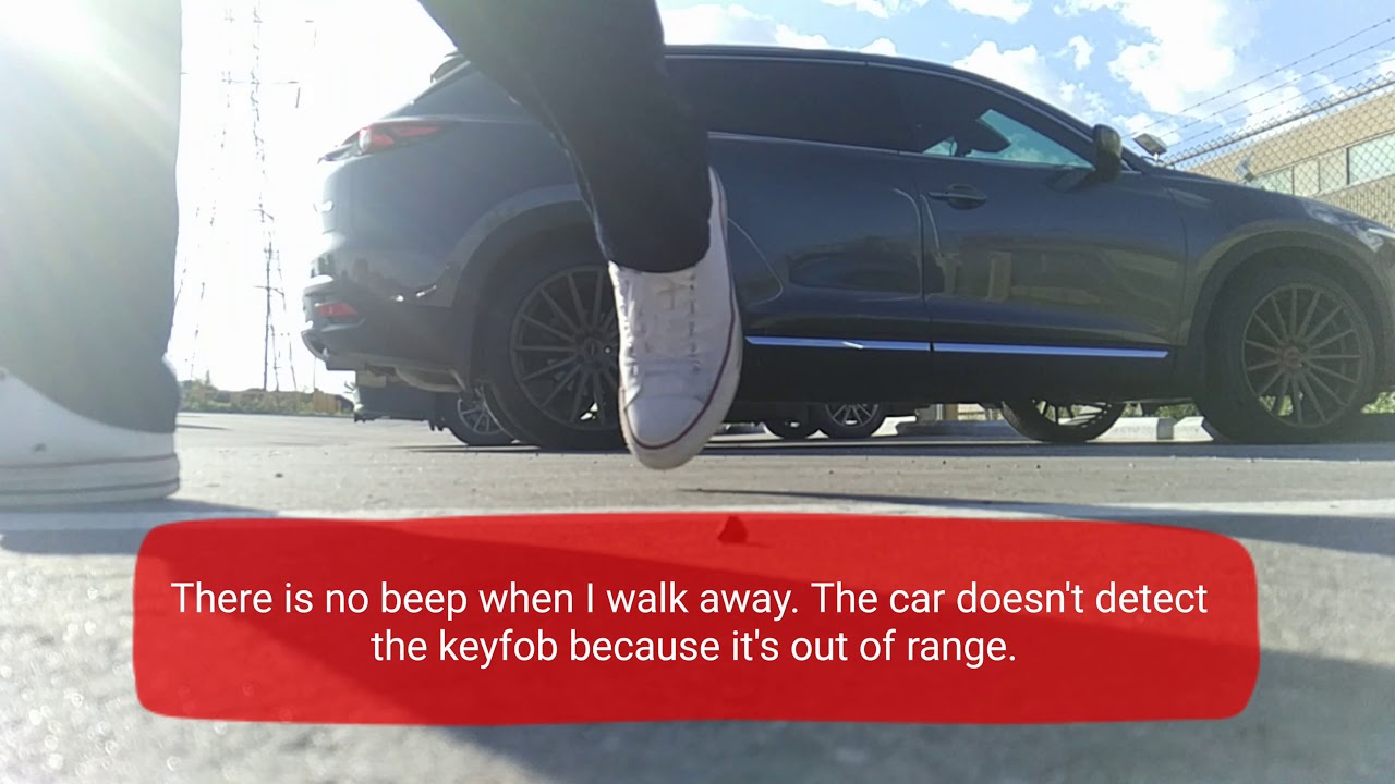

You have to be fairly close to the car when the door closes. Say, if you push the door and walk away immediately as the door is closing, you'll be too far away when the door closes and it does not lock. Close the door while standing close, you'll hear a single beep tone (armed) and when you walk away all of the turn signals flash once indicating the car locked.
Same with the rear hatch. If you're not close when it actually closes, the car does not lock.
I'll check again tonight. I tested to see if it was an issue of distance or timing. It doesn't seem to be the case. Maybe you're right; you have to stand really close to make it work 100% of the time. I do know that it works most of the time when you just stand at a normal distance. I'll try to stand right next to the handle and see if that makes a difference.

It seems the detectable range between the keyfob and the proximity sensor may be wider on your CR-V than it is on most Mazdas. You don't necessarily have to walk alongside the car like I did in my video, just close the door and wait for the beep before walking away.

My 2016.5 CX-5 GT does this, now and then. But I'm convinced it's on me and my method of exiting the car.
So far as I've been able to determine, it's always tied to my rapidly exiting the car.
How I successfully get it to lock on its own when I exit the car:
1. Turn off the car; exit.
2. Close the door; hesitate for about half a second, by the door; then move away from the car.
3. It auto-locks every time. Always.
I've fiddled with the distance from the car and the speed of my moving away from the car, but generally speaking it seems to fail to auto-lock when I move too quickly away from the car as the door's closing or just after it has fully closed. Something about the Advanced Keyless Entry System's recognition of the key fob (in my pocket). Exit more slowly, it always recognizes it; but, exit too rapidly and move away from the car too rapidly, the system will frequently fail to recognize the fob's exited the car.
Of course, I'd wish the car would be speedy enough to recognize this under all conditions, but that's not the case. A minor adjustment in my method, and the problem's sidestepped.
I'd suggest simply slowing your exit from the car. Deliberately close the door, briefly wait by that door for a moment, then begin moving away. I'll bet you will start to see it always locking; else, slow down some more, giving it the time necessary to recognize the fob's outside the car.
