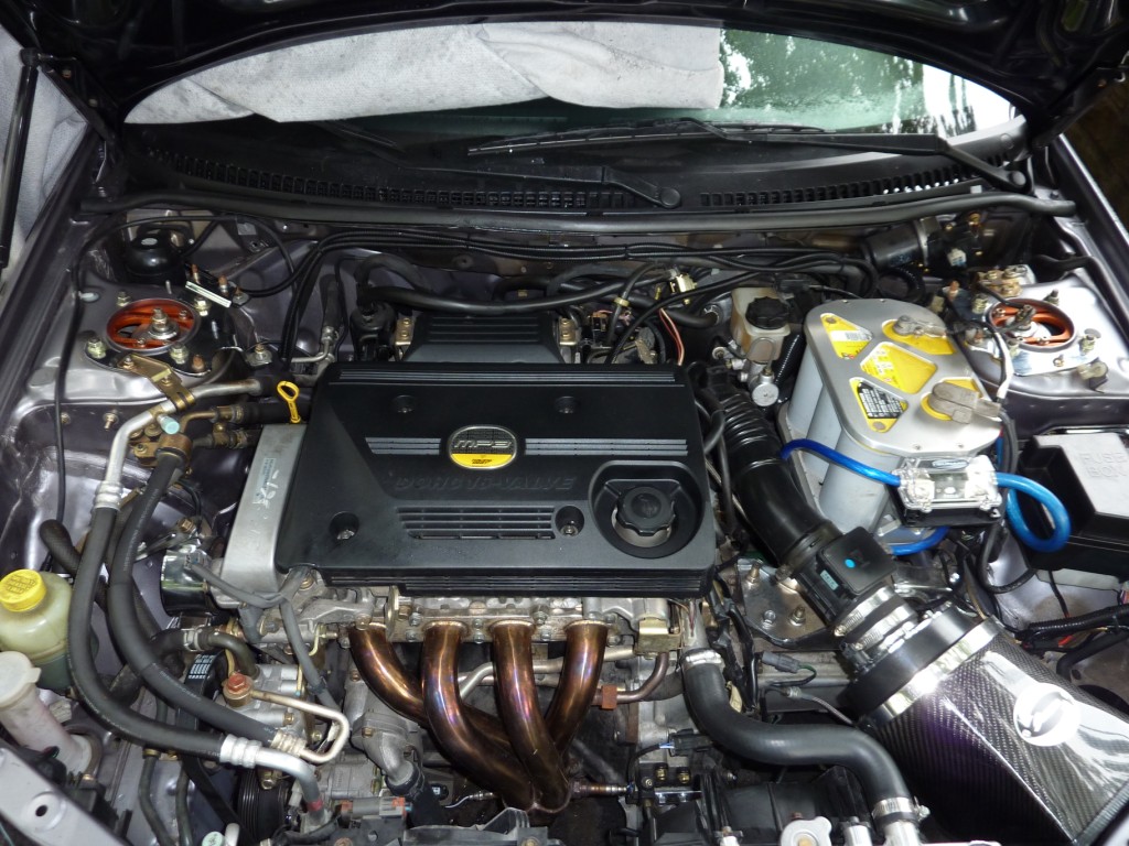

FS-ZE engine came with:
- Higher compression pistons (10.4:1 and 10.7:1 versions)
- Improved cams
- Different intake manifold
- Different exhaust header (4-2-1) too IIRC
- Rev limit of 7,200 rpm
Only the intake cam is different. I thought the 10.7:1 comp pistons were a Mazdaspeed product? I can't say with any certainty.

I'm pretty sure there's a j-spec IN cam & EX cam... I thought the fs-ze had them both.
All of the above is correct (both cams), with the only thing not mentioned that I can think of being the 15lb flywheel. I'm not sure about the exact compression ratio though.FS-ZE engine came with:
- Improved cams (intake and exhaust)
It was the FS-ZE engine, had the special cams and ECU I believe that give it the extra power. I don't think anybody can get the ECU to work though.
Never weighed it, but 23lbs AFAIK. The Fidanza is super light, but does have its drawbacks. Namely, engine braking doesn't really work anymore as the flywheel is too light. Also, acceleration is really a stop/go feeling in the sense that the car bucks a little when you blip the throttle...idling is also a small issue in the sense that the revs jump a little since the ECU doesn't understand why the flywheel is so light. Acceleration in the first couple of gears is always fun thoughJust curious, whats the weight of our oem flywheel? Next spring I want to switch to the fidanza light weight since I am probly going to do another tranny swap again anyways.
Never weighed it, but 23lbs AFAIK. The Fidanza is super light, but does have its drawbacks. Namely, engine braking doesn't really work anymore as the flywheel is too light. Also, acceleration is really a stop/go feeling in the sense that the car bucks a little when you blip the throttle...idling is also a small issue in the sense that the revs jump a little since the ECU doesn't understand why the flywheel is so light. Acceleration in the first couple of gears is always fun though![]()
