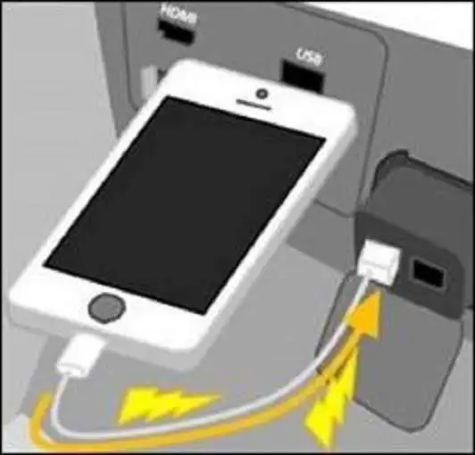

This information is from Mazda Japan (MMC) and applies to ALL Model Mazda's worldwide with the factory installed electronic Ignition Push Start/Stop Button MADE from Mazda 3 2014, plus Mazda 2, Mazda 6, CX-3, CX-4, CX-5, CX-7, CX-8, CX-9, CX-50, CX-60, CX-70, CX-90, MX-30 , etc.
The issue or complaint..
Engine will not Turn OFF when vehicle is parked and START /STOP Push Button is Pressed.
The cause....
Due to the reverse power supply from electronic devices with its own internal batteries to the vehicle through the accessory socket (on dashboard), the vehicle system may not be able to determine the vehicle electronic status.
As a result, the vehicle power supply control fails.
To overcome this situation, remove any electronic device with internal batteries from the accessory socket port.
The Mazda vehicle should then power off as normal as soon as and after any Battery Powered DEVICE is disconnected from cars power supply port.
The DEVICE (like mobile Phone) can resume being battery charged via ACC Mode after engine has shut down.
This situation is not considered a manufacturer defect.
