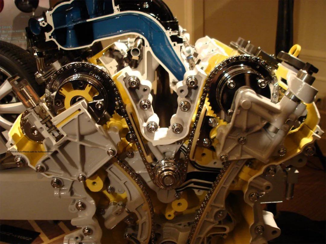

From past experience, the wrong oil in a HLA engine can gum up the lifters. I don't know what hydraulics the CX9 specifically uses, but 2 of my 4 Mazda trucks had permanent lifter problems after someone used the wrong oil.(One a previous owner, one an oil change shop) I do know that the CX9 has a complex valve system. I won't mess with it.
I trust Mazda to know exactly which oil should be used in the engine they built.
