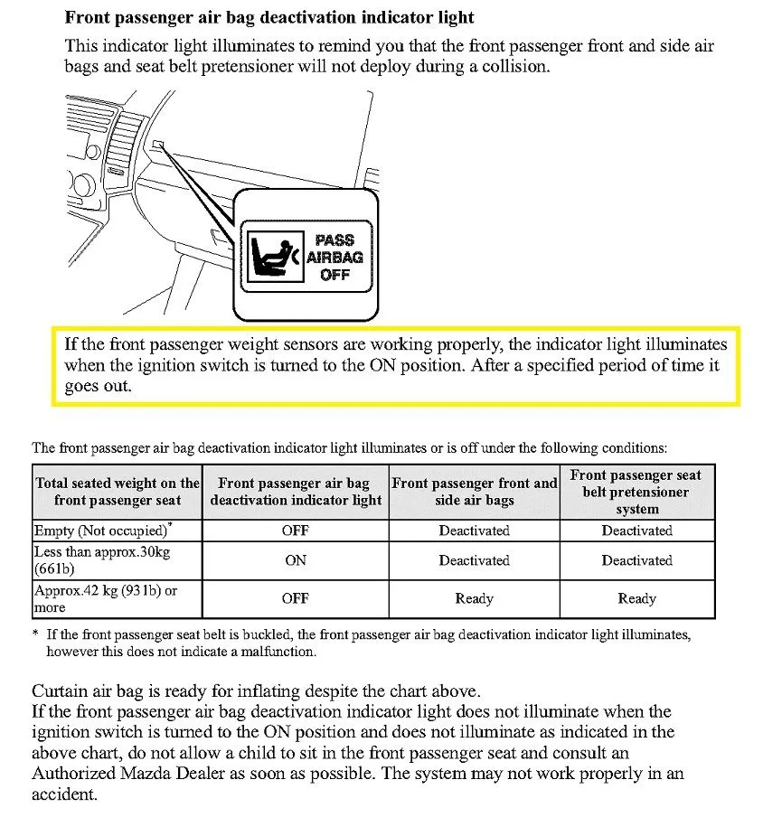

i believe, as long as the light turns off, it means that the airbag is armed and ready. it senses the weight of the passenger, thus the 3 second wait. just like how all the light on the dash light up for a second when turning on.
From my owner's manual -
attachment.php
If you're on a MAJOR weight-loss program and you sit in that seat and the light stays on, you have succeeded in reaching your goal.
Or the light would be OFF and the airbag ON. The passenger seat airbag sensor says it registers at 66 lbs., but it lies. The dealership says the sensors are not accurate, and YMMV. My 16 YO son is a lightweight at 120 lbs. (26" waist 34" leg), and it was about 50/50 that he would trip the sensor so the airbag was on until he was over 120 lbs. He used to take Judo, and I would drive him to his classes, and the airbag would be on going to Judo, and off coming back. He weighed 100 lbs. at the time and the difference in water retention could be enough to drop his weight below the sensor's capabilities. Eat a big meal and the airbag would be on, take a big dump and the airbag would be off.
