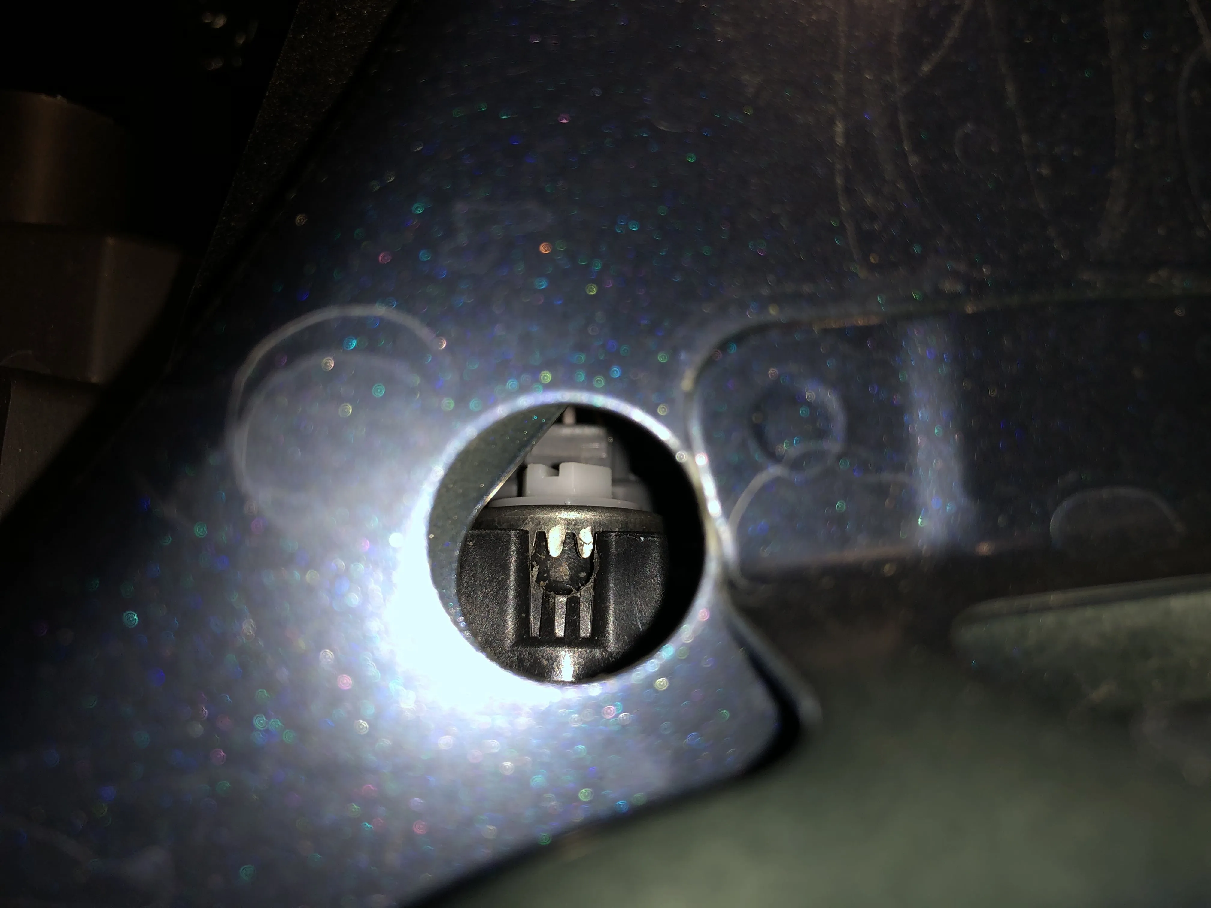

With regard to the foglights, it looks like they are adjustable as well. I don't know for sure, but the adjustment knob appears to be the white plastic one at the bottom of the assembly in this picture.

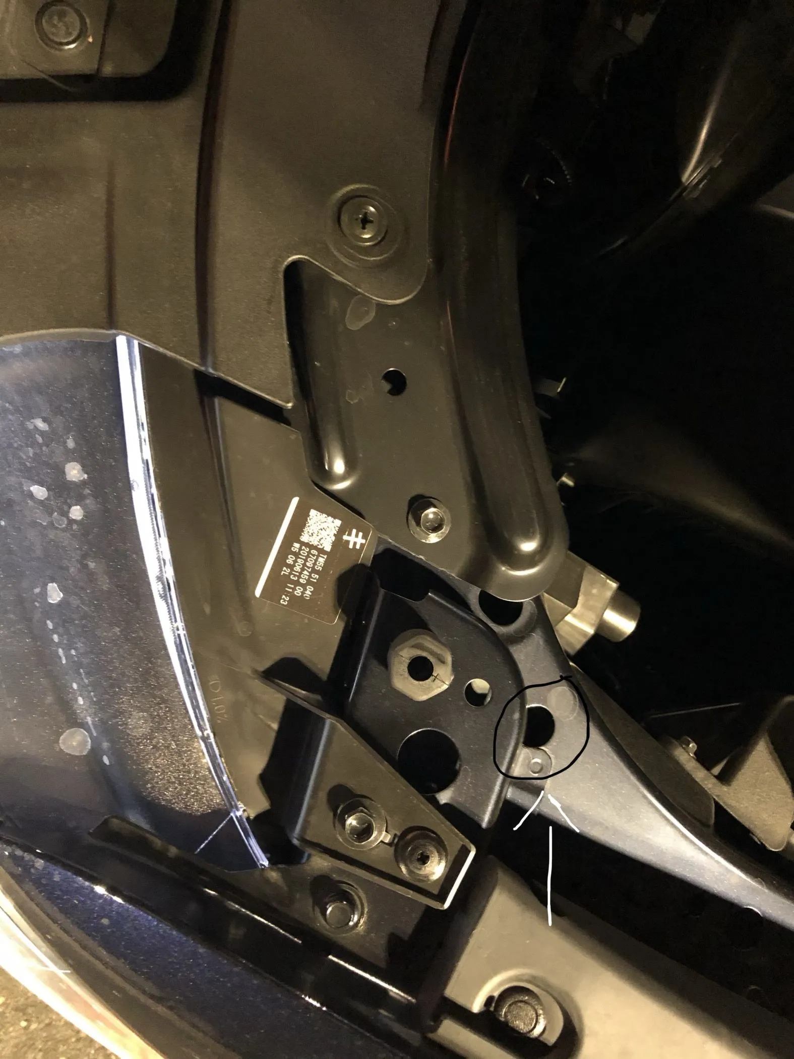

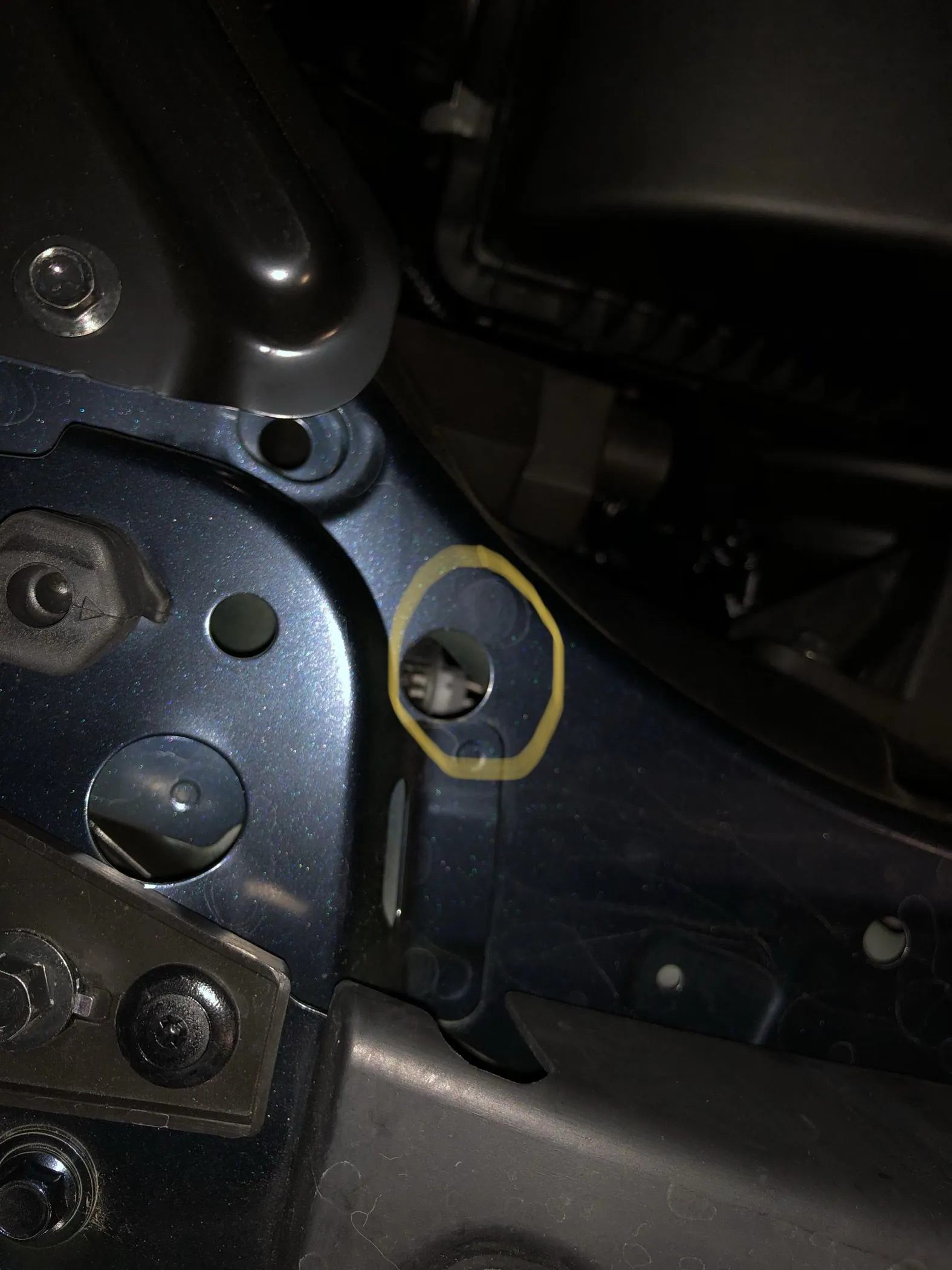

I’ll take pictures tomorrow. Very easy to adjust. Look from top of headlight down and you will see an adjustment screw. Just need a Phillips screwdriver and clockwise will lower lights and counter clockwise will raise. Don’t know anything going left and right with any adjustments. I would assume it’s computer based if even possible.

Here is where the adjustment screw is located. Counterclockwise raises and clockwise lowers the lights
I think I saw that. But, I didn't think it would be the adjustment screw since you mentioned that a Philips screwdriver was used to perform the adjustment, and I couldn't see how a Philips screwdriver can be used. I'm gonna give it a try later. How much higher did you adjust yours, like an inch higher or more?
I adjusted mine up a little bit. I was about 20 feet away from a wall when I was doing this. Be careful as these lights have a auto level feature so If you raise too high it will motor up and you will have to bring it back down. Seeing how easy this is to do I’ve found myself super critical when adjusting this and wanting to adjust more to dial it in precisely. I’m very happy with the headlights. Now all I need to do is raise the fogs a little and all set
