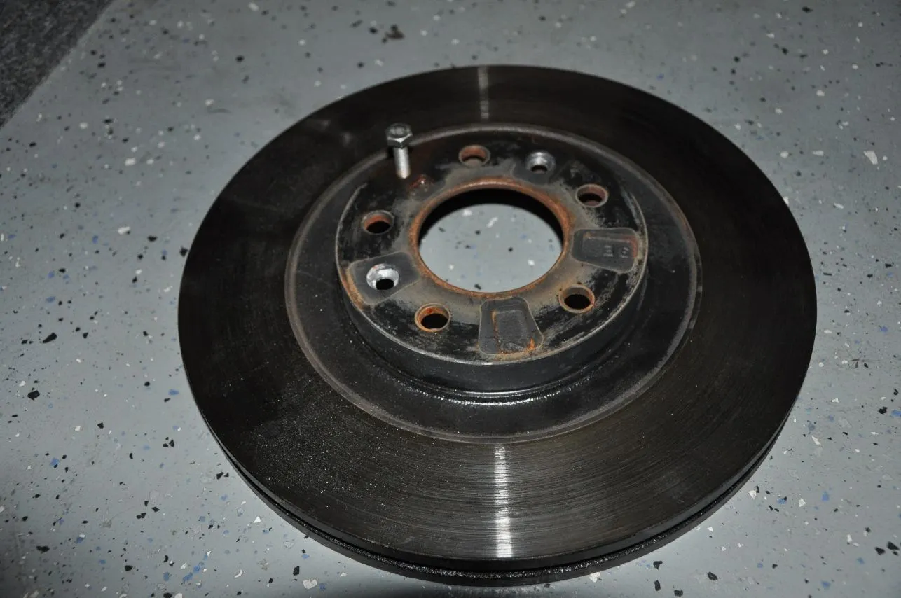

Easy work. I just did mine yesterday. Both front wheels in about 90 minutes. You can find many posts and pictures with DIY. Most likely you will have to drill through the two fixing screws. One other thing not every post was talking about is removal of the old rotor. Over time they get stuck and banging on them with a hummer won't help. You will need a M8 bolt to screw into the threaded hole in the old rotor (see the picture).

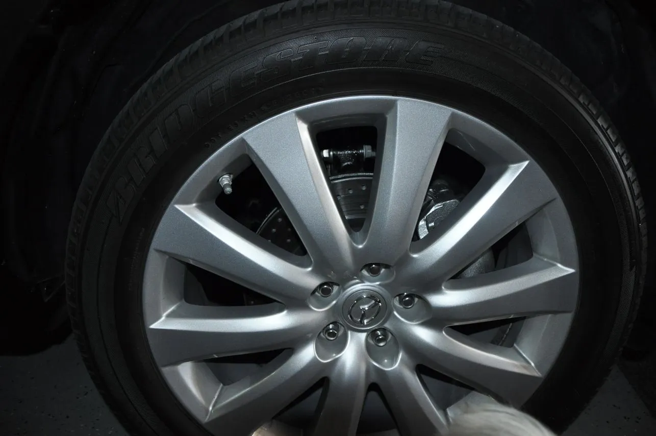

I used Centric E-coated rotors with Centric Posiquiet ceramic pads. Have only put 100 or 200 miles on them since the swap so I can't speak for longevity, but so far real good.
