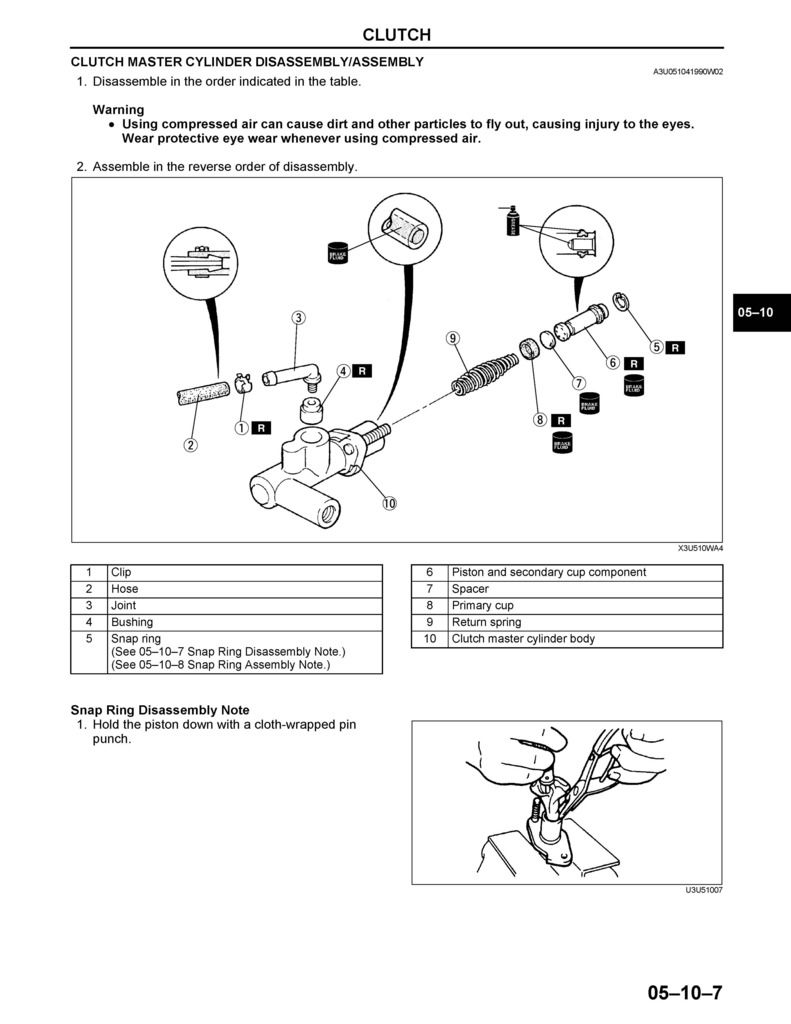

Had a chance to pay attention for the symptoms you describe and I don't have those. I do have a loudly squeaking pedal though, and googling that produced a lot of results. So I'm thinking of whether I should pull the clutch pedal apart, as well as the clutch master cylinder, and rebuild those with new seals/bushings etc. Has anyone done this, and if yes, any writeups with pictures? Can I even get a seal kit for the master cylinder (new one is $140).

If the clutch system is leaking down, pumping the pedal will bring it back for a short while. Could be master or slave, the slave will usually leak fluid though, the master will just bypass, and the fluid level will stay the same.
When it won't go into gear, have you tried just letting the clutch out in neutral for a bit, then trying to go back in gear?
I think you're on the right track with looking at the hydraulic system.
The clutch isn't disengaging entirely, but I'm not sure why it would only do it while hot. I would check the fluid level and condition, and then rebuild/replace the master cylinder. Hopefully, it isn't the slave.

Thanks! I'm going to call them tomorrow and find out. I see in the service manual there are instructions for disassembly/assembly and the parts listed for replacement are a bushing, primary cup, spacer, piston and secondary cup component and snap ring (not sure why you couldn't reuse the snap ring). The procedure looks pretty straight forward... They don't say to replace it but I wonder if the return spring gets weak?
