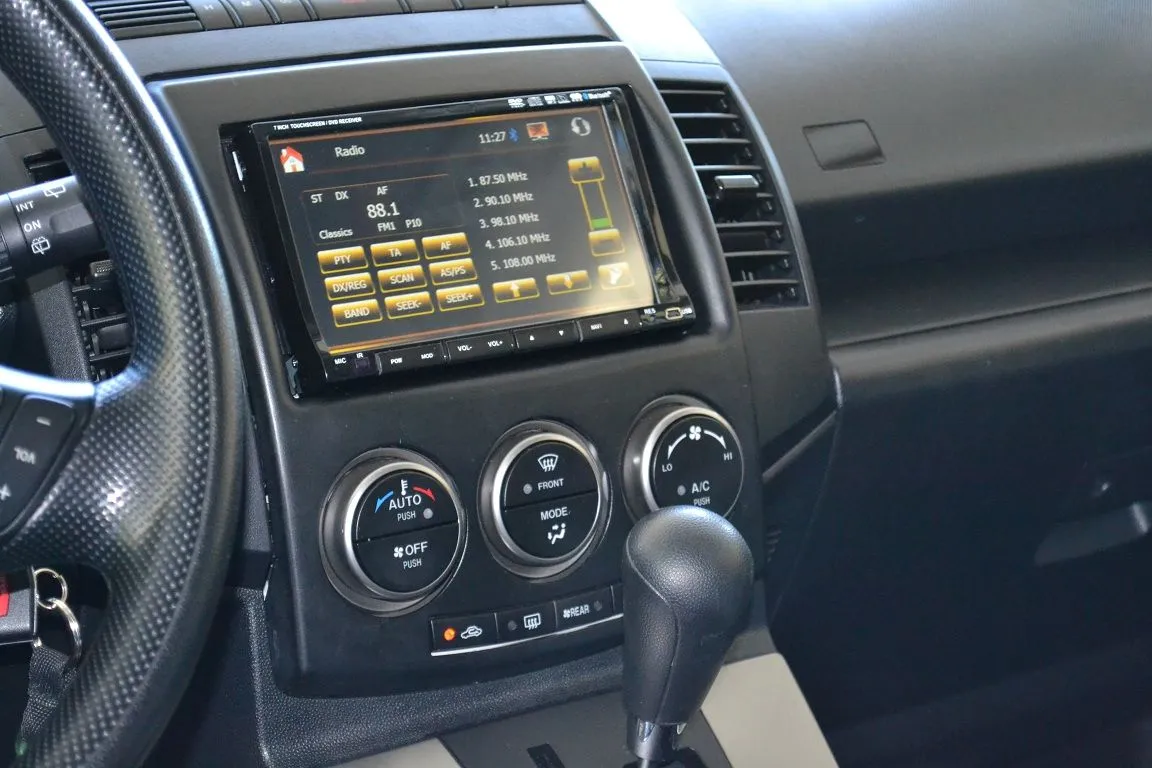

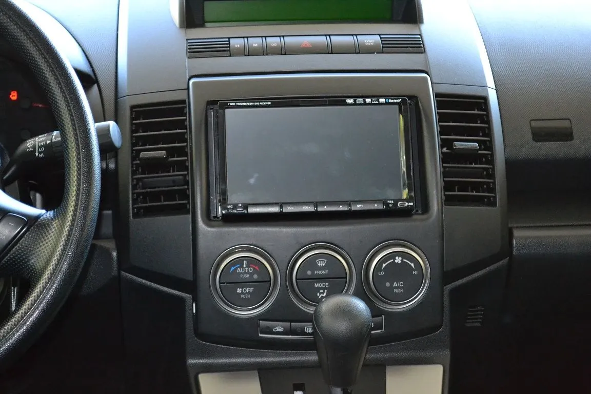

As I mentioned earlier, I removed the Metra cover and painted it in black (Black flat spray paint: $4.58). Before painting, I sanded the surface to remove existing paint. Please see attached pictures.

Looking at the pics, there seems to be a gap between the dash kit and dash. Also the HVAC buttons seem to be recessed a tad, are you sure it is mounted correctly?

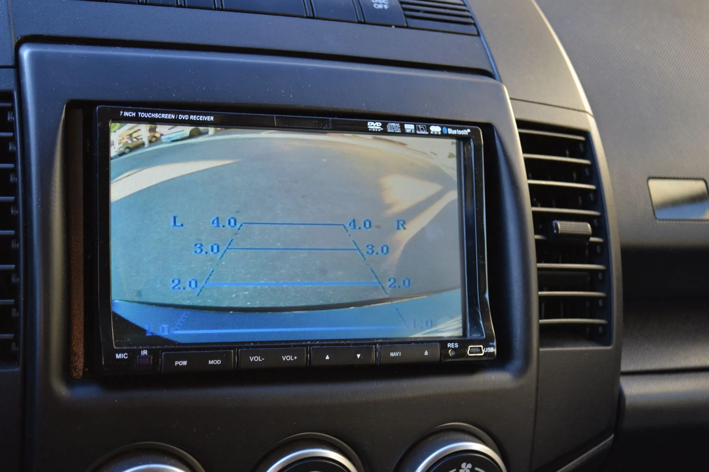

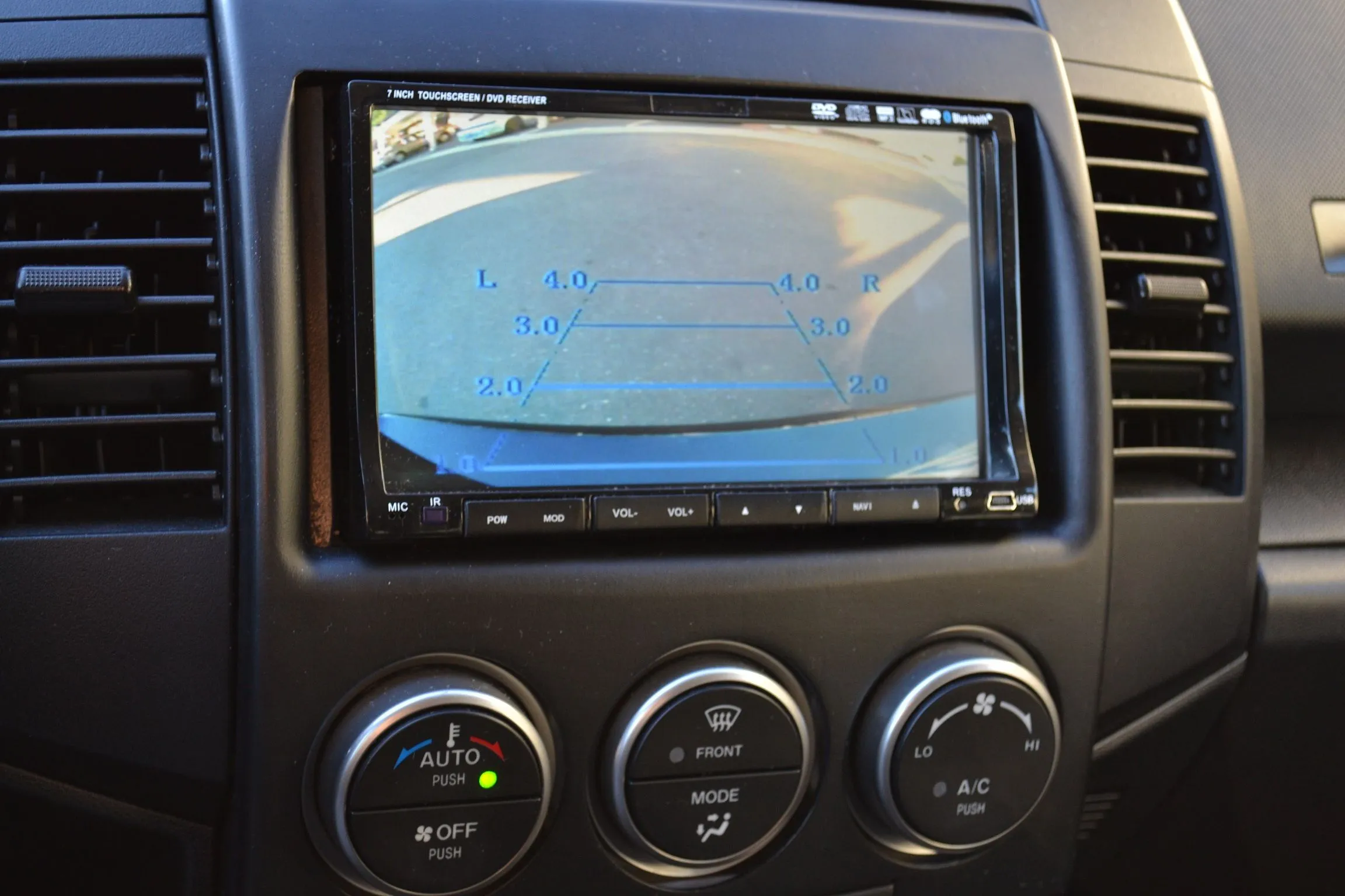

Here are some of pics.
Quality is good. But sometimes I get interference signal. Before finalizing the location of the transmitter, I turned on the system to see the quality of the image. Then, I realized that the orientation of the transmitter is critical. I found the best orientation and used Velcro strips to attach the transmitter to theliftgate. If you want to get a quality signal without any interference, you have to run wires to the front.
Installing camera: I removed the existing lamp cover to install this rear view camera. It does not come with a waterproof seal. One of the downside of this camera plate is it comes with two unnecessary openings. So I got a sticky sponge tape and covered openings and made it waterproof. This camera not the best. It doesn't have infrared LEDs. So you cannot see much in the dark.
Yes! it was mounted correctly. Metra cover is not fitting really well. But that is the only available cover in the market (Scosche cover doesn't work for this double DIN unit)
