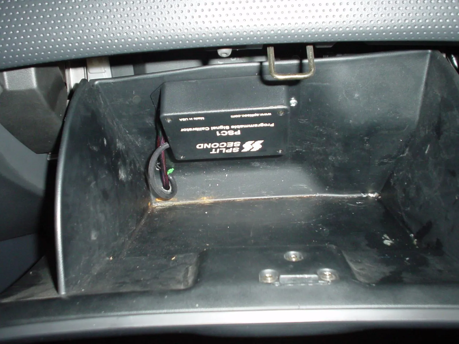

vxfilmer1000 said:
I wouldnt mind seeing some pics of where you mounted it either.
Inside the glove box. I just drilled two small holes to run the wires through.
