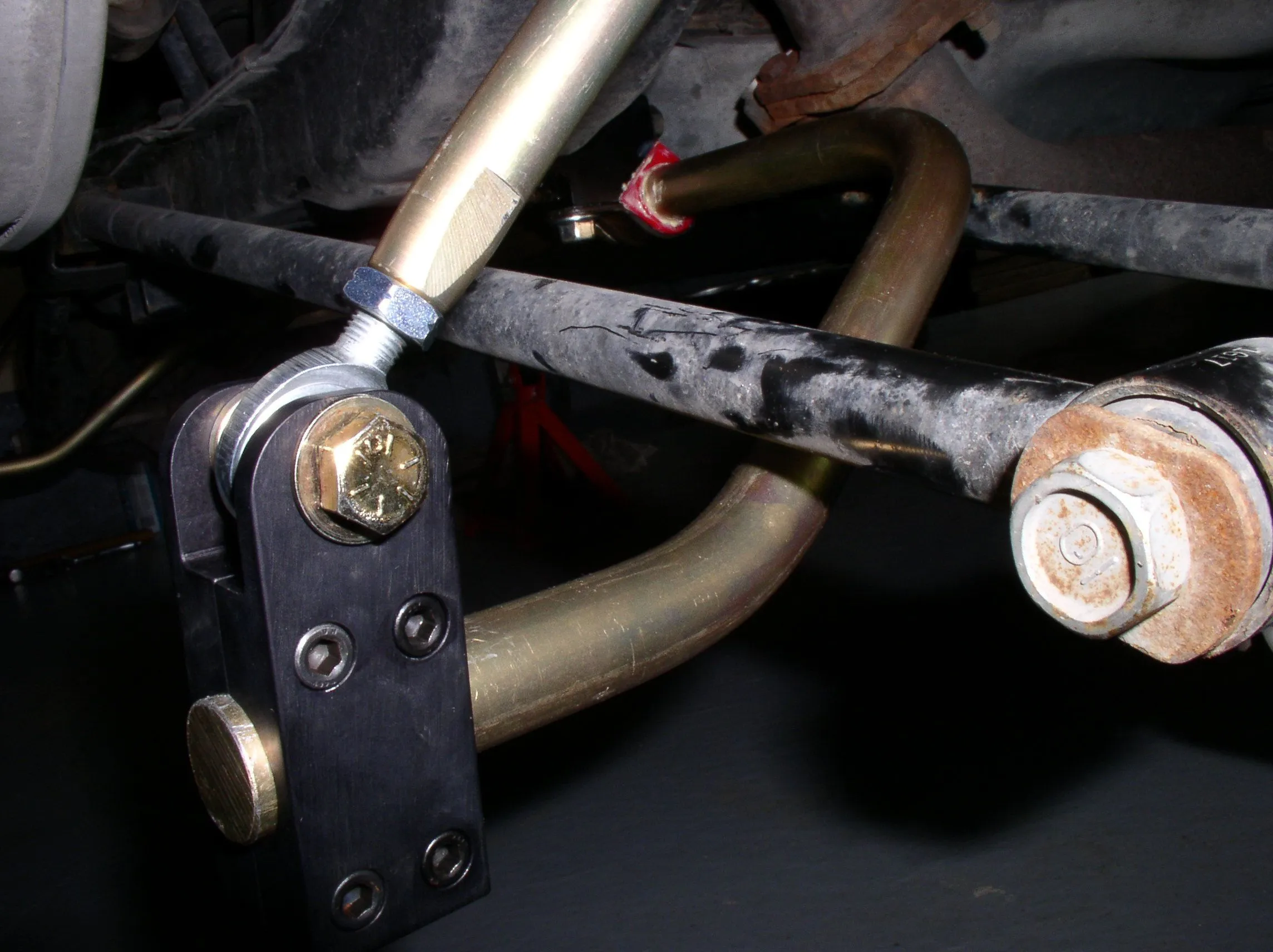

You can also buy AWR endlinks if you want. They are a bit more expensive and a bit more noisy.
But they are easy to work with.
Attached is a picture of them on a fully adjustable swaybar. But you can get a set for regular swaybars.
