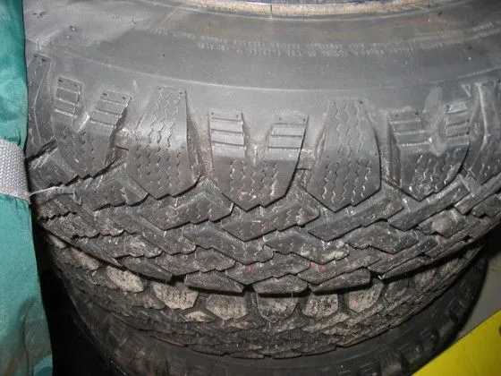

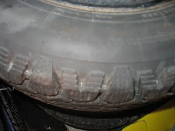

That's exactly the same size I bought for my P5. No issues whatsoever, well...the rear brake calipers siezed but I think that was just the typical thing from the TSB. Mazda fixed that under warranty.
The wheels I bought used for $20/wheel from a Tire&Wheel place. They were in really rough shape (mega rust), but I cleaned them up and painted them.
Hope this helps.

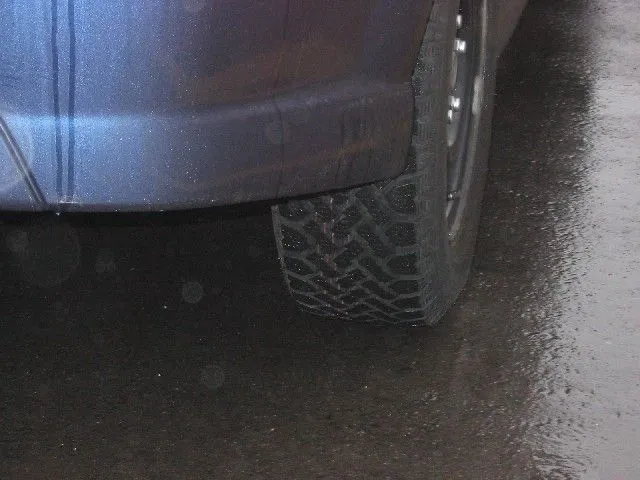

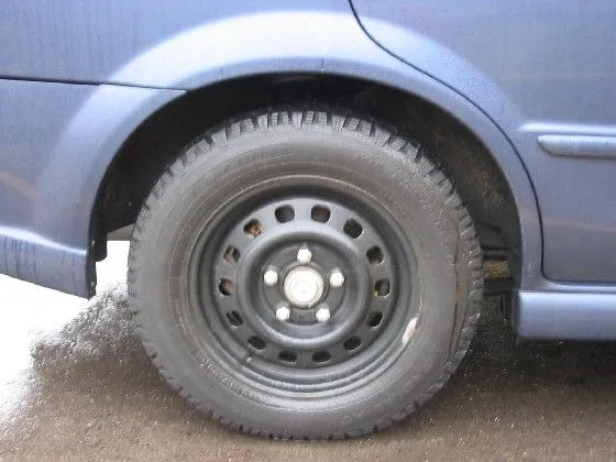

15" steel rims (new aftermarket), with Goodyear Eagle Ultra Grip GW3's, size 196/60HR-15...
Ultimate winter sport rims! Love them...

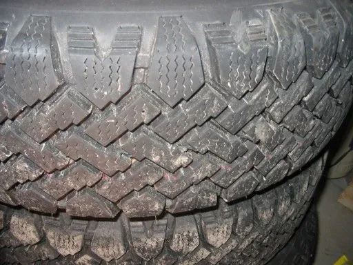

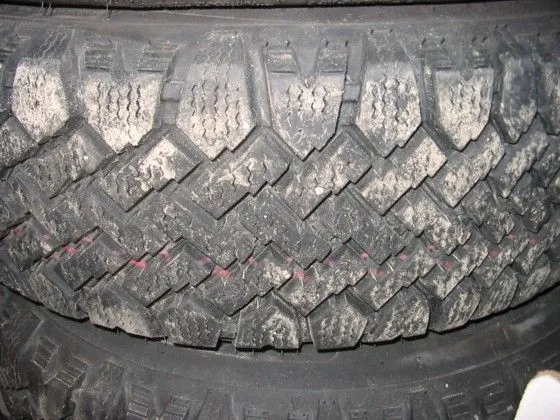

Yah, I've got the Pirelli 210 Snowsports too... I put them on the stock wheels and bought new summer wheels. Still wanted to look good for driving around Vancouver, but needed the winter tires for driving to Whistler every weekend.
Gotta say, the Pirellis handle amazingly - definitely buying these again.
After 4.5 months on the road, no noticable wear. Cheap CAD$70/each at Walmart.
where u get the rims
Bought the rims through Wal-Mart for about $200 CAD, and the tires from the local Good year retailer. The rims work well, steel and black, while the tires are great... seriously good winter tires.
