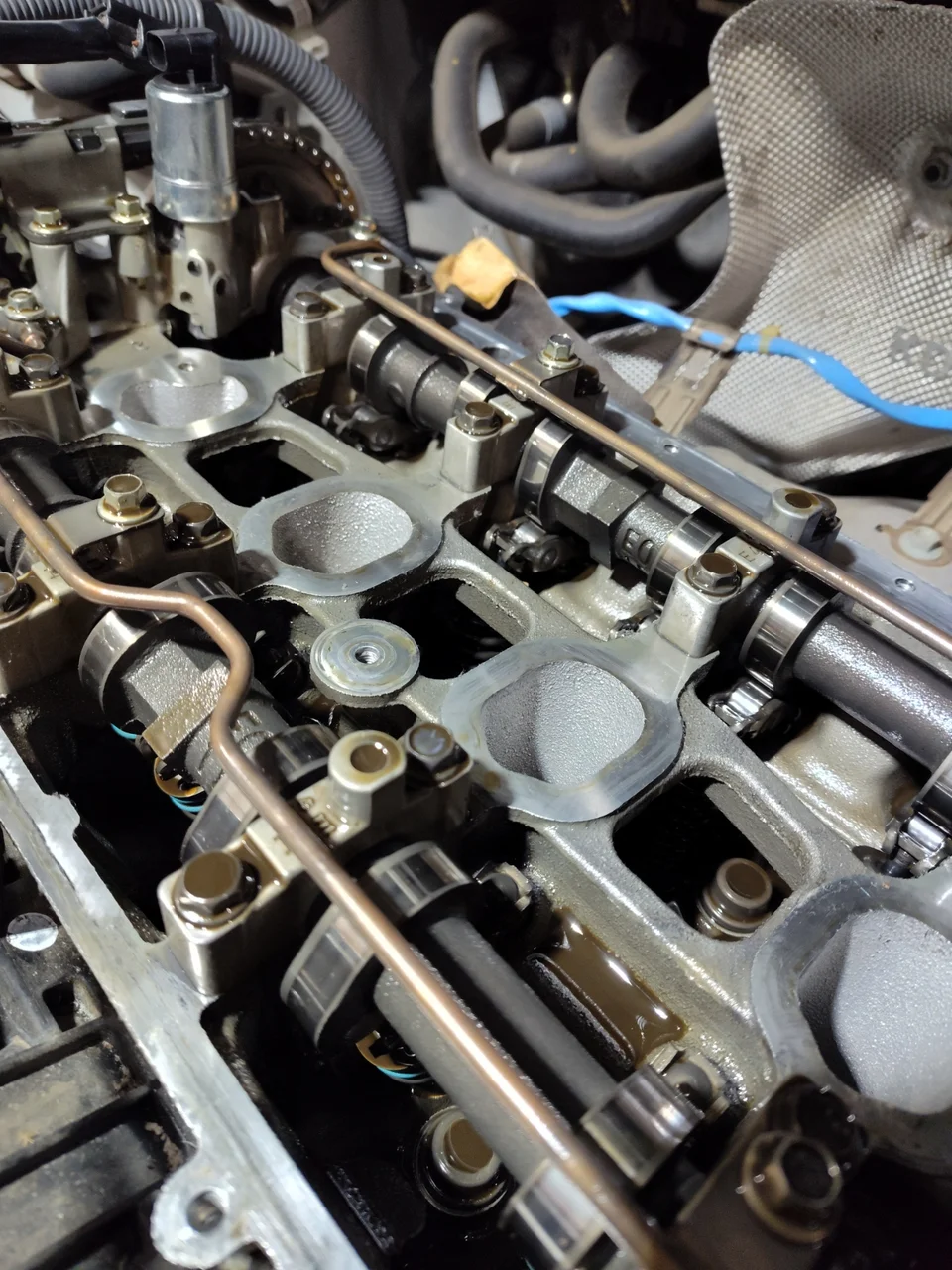

I replaced the VVT and was very hopeful because in a couple hours of driving the idle only dropped once. But after a few weeks it has gone back to where it was before with the frequency. It is really odd that it changed for awhile.
On the plus side, modern motor oils are amazing, I've never run any flush or extra cleaners with the oil and after 339,000 miles it looked like this:
Off topic, but that looks great! How often do you change your oil? And synthetic oil im assuming?
